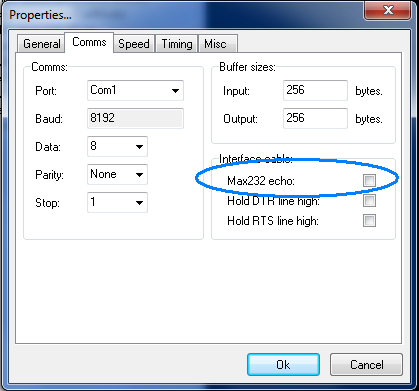

    Try unchecking the Max232 echo option.

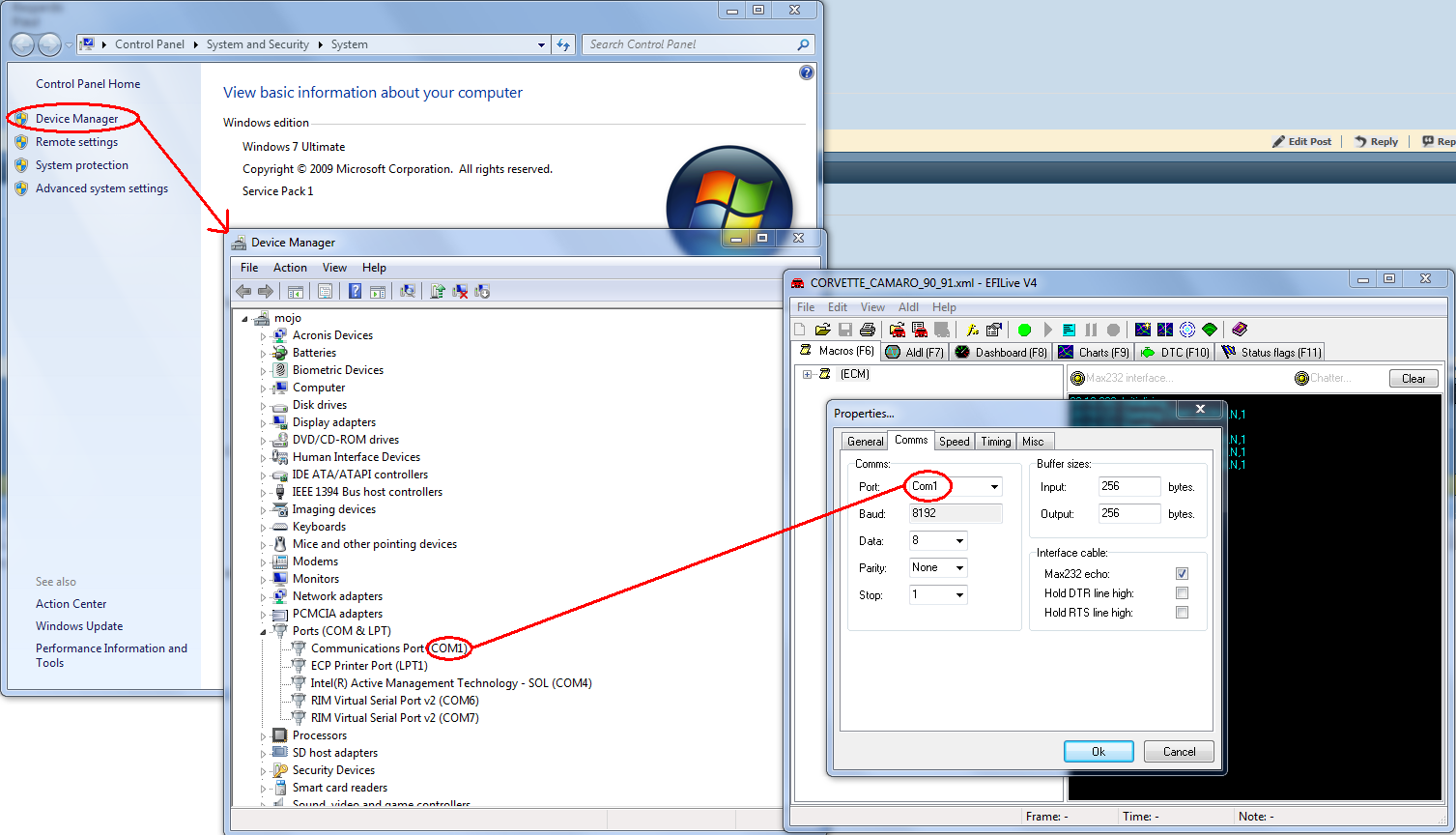

    Make sure the COM port being used by the USB cable is the same COM port that you have set up in the EFILive software.
