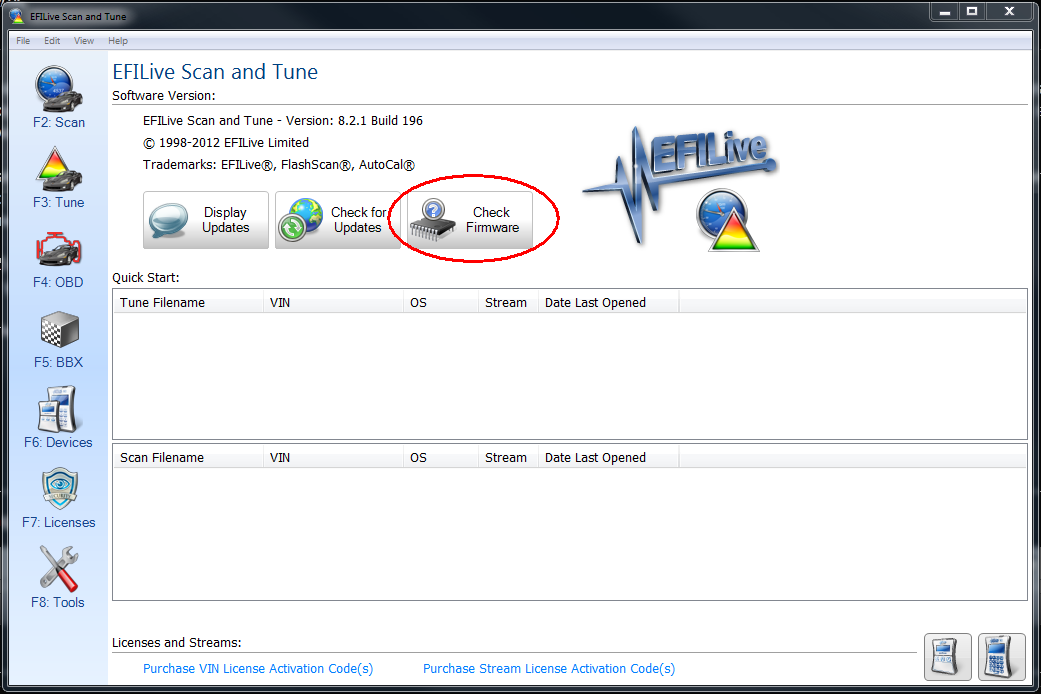

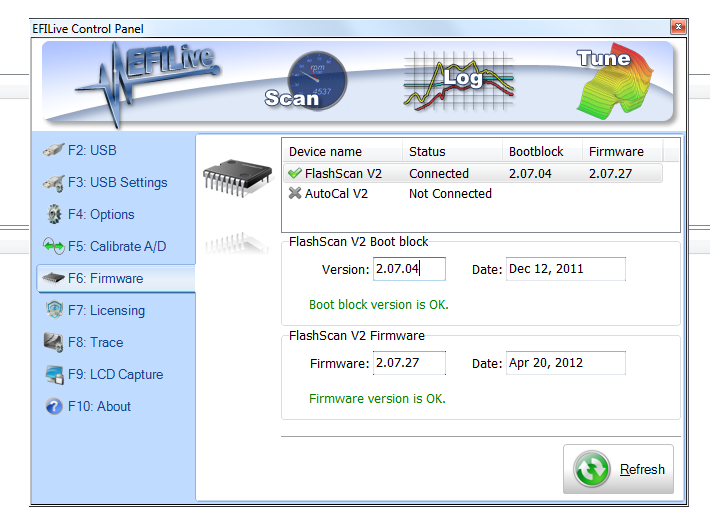

    As Taz said, the icon can be difficult to find depending on how various desktops are configured.
    The latest V8 software version, available here: http://www.efilive.com/index.php?opt...=48&Itemid=133
    has an easy to use button that opens the control panel at the firmware page and shows you the firmware status.
