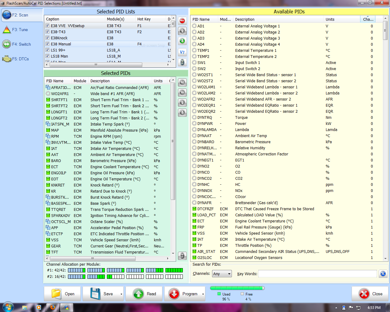

    Also if you look through your PID list on the BBx setup there is a lot of stuff you can log via the TCM instead of filling up your ECM list. I am logging coolant, intake temps and RPM just to name a few

    Can I get a screen shot of the rest of your pids?
    Also do you have any maps you can share for reading data logs

    Here is a copy of my PID lists 17-10-2011.txt
    Save that to EFILive/V8/tmp and you should be able to open it up in the BBX tab
