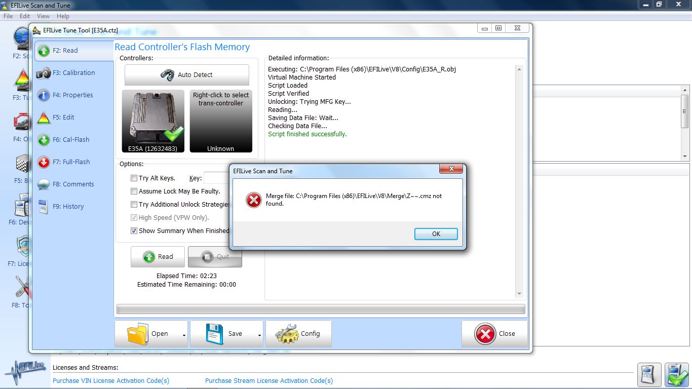

    Updated and got this today.

    Quote Originally Posted by SkinnyPedal View Post
    It was a known issue in the previous version, thought it was fixed in this version.
    Working on this right now, should have a solution available in the next hour or two.
