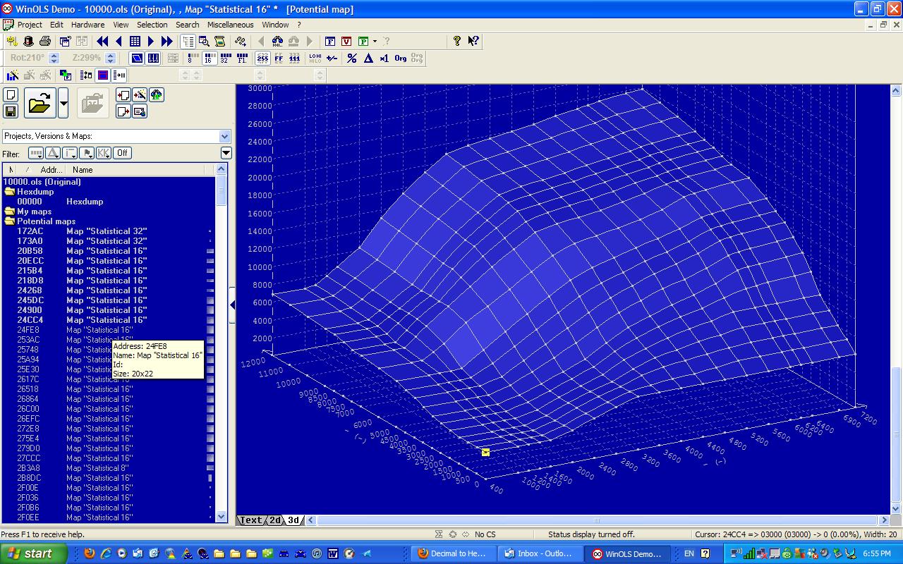

    This is what some of the hex looks like with third party software
ID:	16171   Click image for larger version.

    Looks like tuner pro to me. I've used it with Bosch ME7 ECU's in the past
