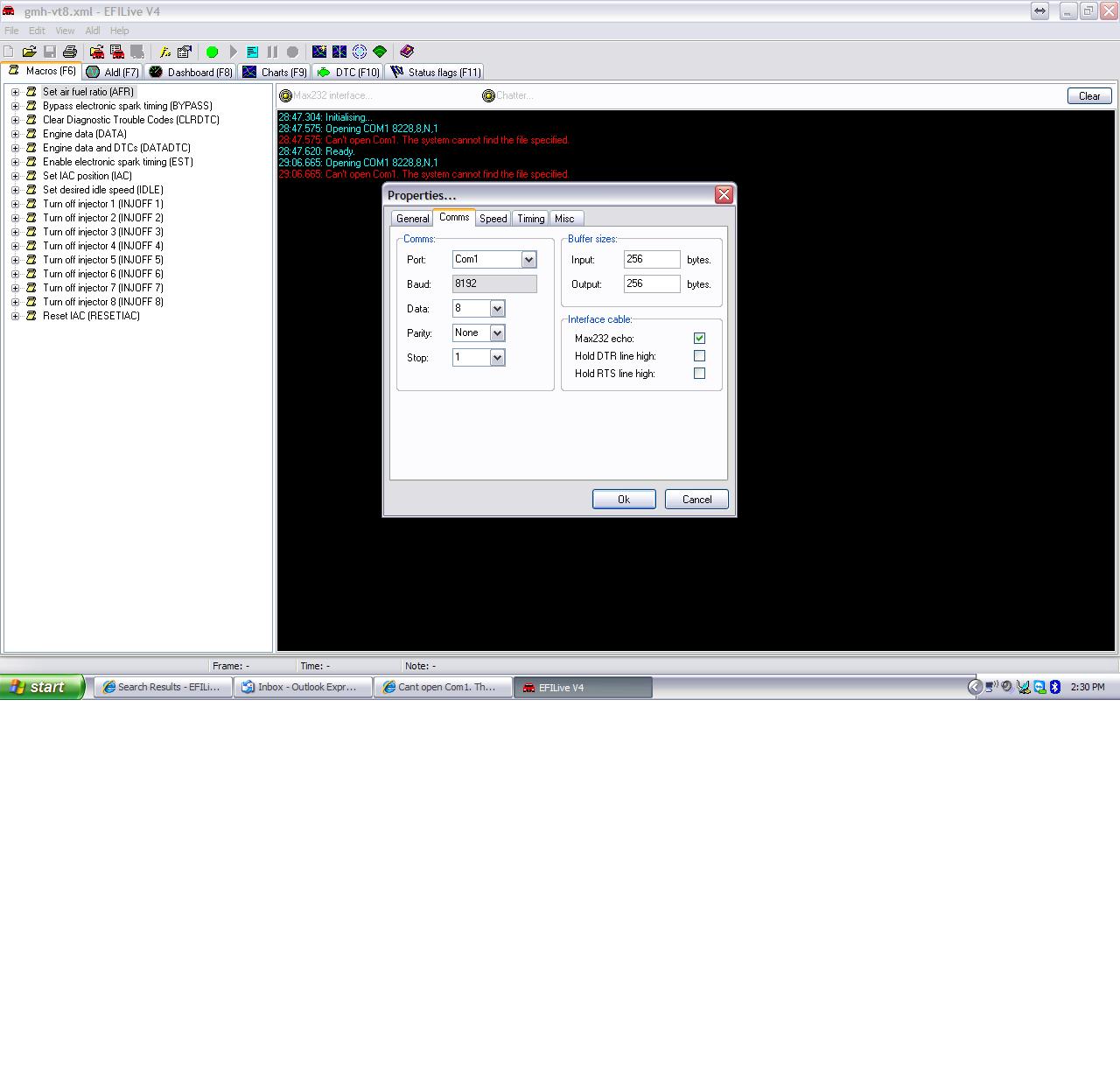

    Go to edit,properties,comms tab and see if the max232 echo box is ticked, check out pic.

    THE MAX232 IS TICKED. iM TRYING TO USE TUNERPRO ALSO. BUT i CANT MAKE HEADS OR TAILS OF IT. iM RUNNING SERIES 1 VT WITH A V6 CONVERSIONS BCM SIMULATOR - ONE FELLA SAID MAYBE EFILIVE DOESNT LIKE THE BCM SIMULATOR

    Are you trying to tune or scan with tunerpro? You could also try unchecking the echo box.
