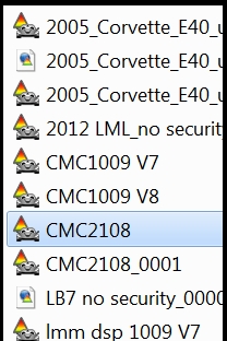

    .coz files cannot be opened. Once they are saved in that format, they can only be flashed. They cannot be opened, and they cannot be edited. If a change needs to be made to a .coz file, your tuner needs to re-open the matching .ctz file, edit that and re-save in .coz format. Additional warnings have been added to our next software release (scheduled for later today) to alert users of the reason why they cannot open .coz files.
    If you view your .coz file in windows explorer, you will see that the icon is still an EFILive icon, however it is different to the .ctz icon. Here is a picture - the second and second last files are .coz files.

    You will now need to go back to your tuner and determine the answers to your configuration file questions, unless they send you your .coz file as part of a Quick Setup, in which case those configuration files will be reprogrammed into your AutoCal during the Program Quick Setup function.
    Your tuner will also need to confirm the software and firmware versions he/she was running to create your files. There MUST be compatibility between the versions they use on their FlashScan to create tunes for your AutoCal.
