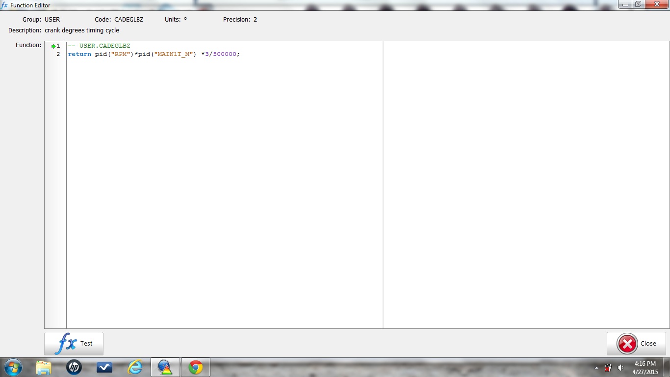

    Well those 2 work. The other one I am uploading a pic of the code. I tried and failed to write the code where I thought it would work. I wouldn't recognize °, or degrees, degree as a Unit of measure.

    Quote Originally Posted by x MadMAX DIESEL View Post

    In V7 scantool, the units you want are "deg" or "CAdeg".

    Try the attached calc_pids.txt.
    ( I did not check, but is GM.MAIN1T_DMA with units us (microseconds) valid in V7 scantool...? Probably is. )
    Yes, it is. I dont seem to be able to view it still though. (no error messages atleast. I guess maybe I need to log a new one and check again after that cal text doc has been saved?

    Nevermind. Got it working thanks !!
