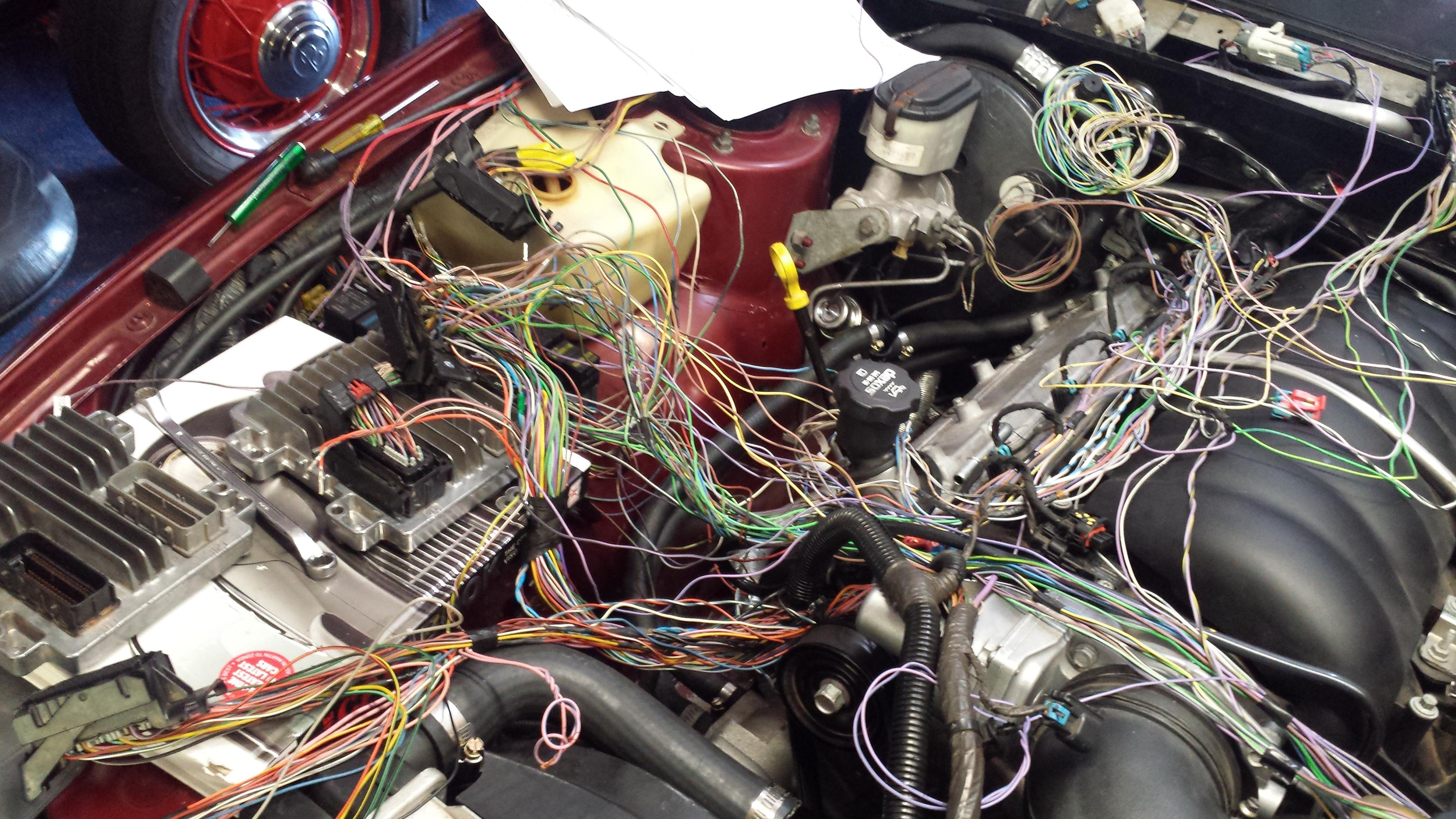

    Yes it was weird, as it flagged other codes, which I was able to sort out, but with this broken cam ground wire to X2-66 (E38) was enough to prevent the ecu from giving the OK to activate/command fuel and spark, and yet no codes or reasons in VTD, which was frustrating..... so it was back to old school.... pull it all apart.....
    I will put a photo up later of the mess, and what a L77 looks like running on 2 different combined and opened up wiring harnesses... not a pretty site.. lol

    74

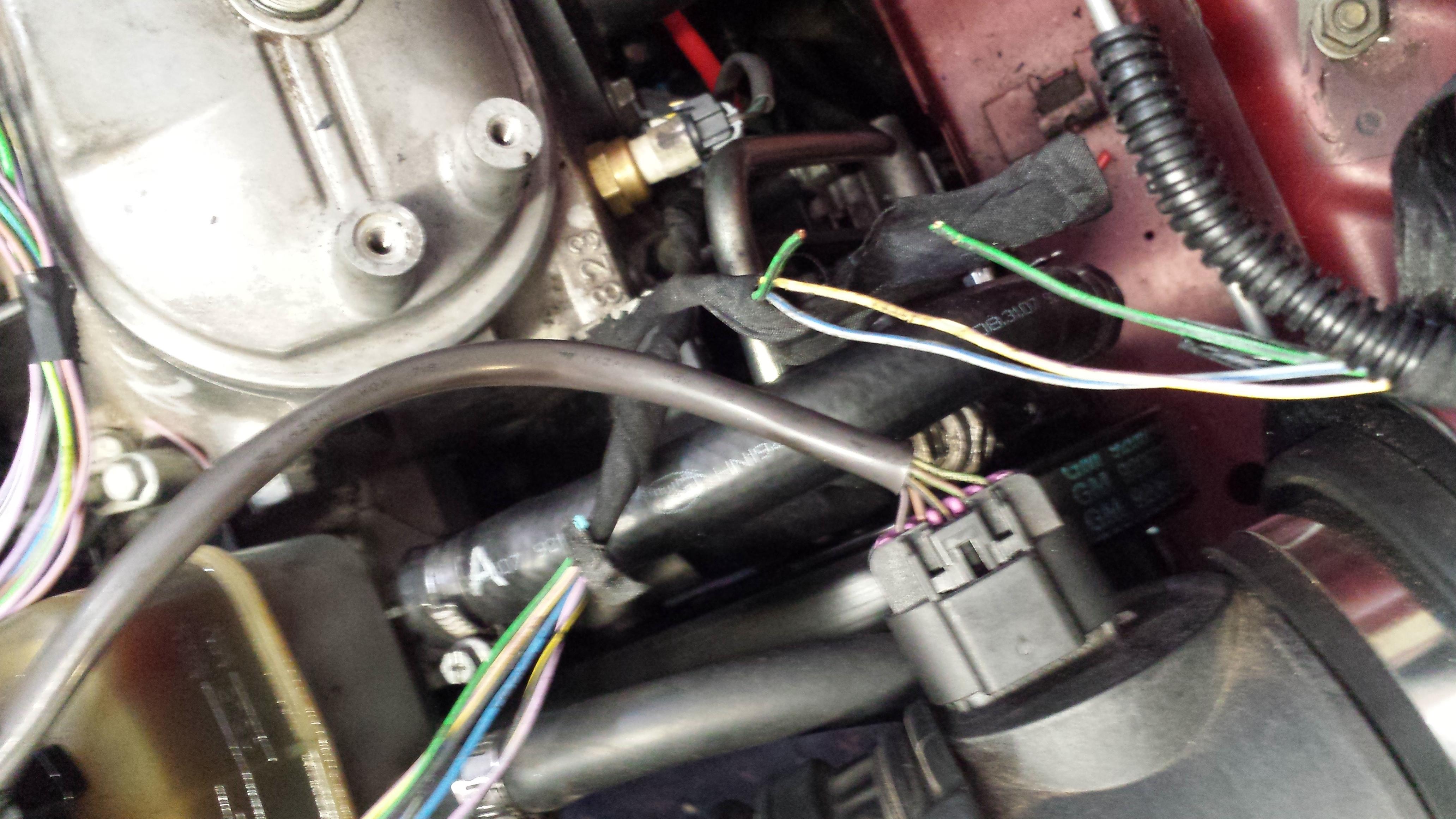

    Not pretty, but at least I had it running.....

    and found the problem

    After much stuffing around using a 2nd harness and then pinning (almost) everything out, and then doing process of elimination, it turned out to be a broken wire in the cam sensor lead. The crashed donor car took a hit on the front left, and although it didn't cut the harness, it busted the earth wire in the crash.
    This was my bad, as I know that these engines will run with the cam sensor unplugged, so I "assumed" this sensor wouldn't be a problem..... wrong.... it will run with 3 wires unplugged but not just 1.... and this is enough to cut fuel and spark....
