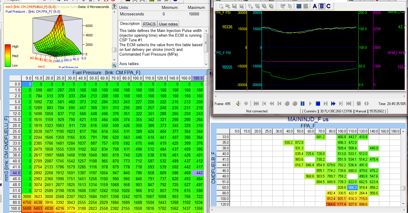

    Hey guys this is my first post here. I have been messing around with tuning here and there and have read much of this forum. A lot of good info here. (thanks to all!)
    The issue I am having is when I try running the data log and look at it in the tune file at the same time for the Main Injection Duration table only. The Purple box moves along the CMD fuel, but it stays in the max fuel pressure column. I've uploaded a screen shot to show that when I map it in the scan tool, everything displays correctly. This does not happen with any other table.
