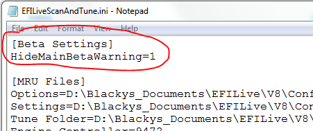

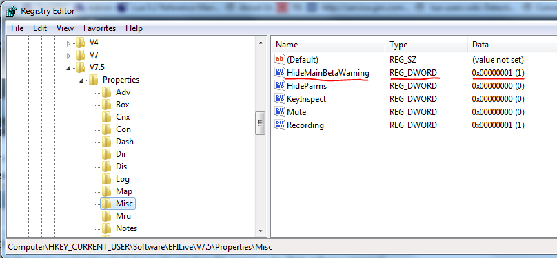

    Mar 2003
    9,535
    Quote Originally Posted by DURAtotheMAX View Post
    Paul, any chance you could add a check box to "do not show this again" on the "Beta software warning"?
    Or maybe just have it pop up only every 5-instances of opening the program? Or just a "BETA" splash screen that pops up for a second and self-clears?
    I do plan on adding an option to allow a checkbox to disable the warnings (even I'm getting annoyed by them). Meanwhile you can stop the warnings like this:
    For V7 Scan and Tune, add a new entry in the registry like this:
    For V8, add a new section and key in the file \My Documents\EFILive\V8\Config\EFILiveScanAndTune.ini :
