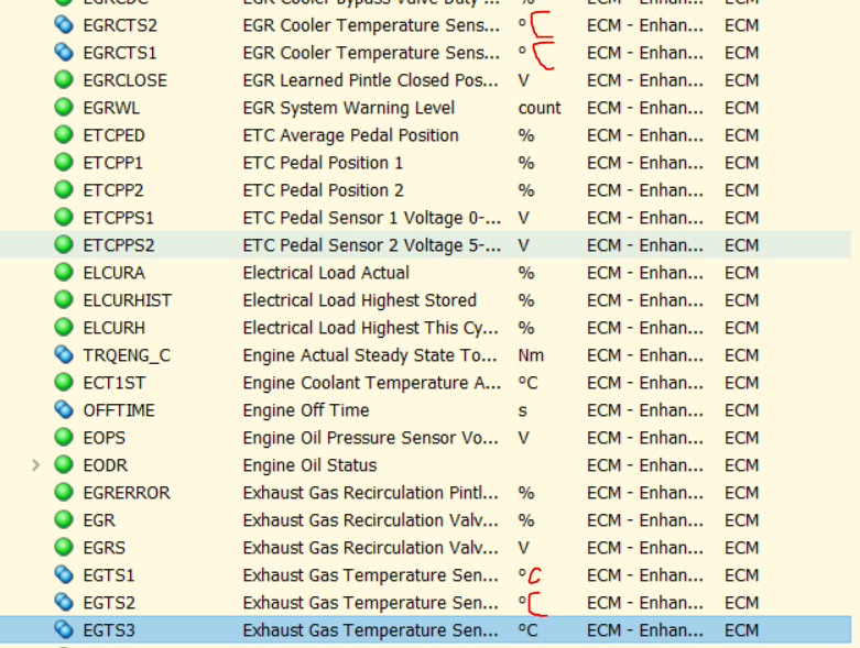

    I think these PIDs need a C (so we can convert them to F). This is on the E47 Cruze and LML.

    Yes, they do. Will get that fixed in the next update.
