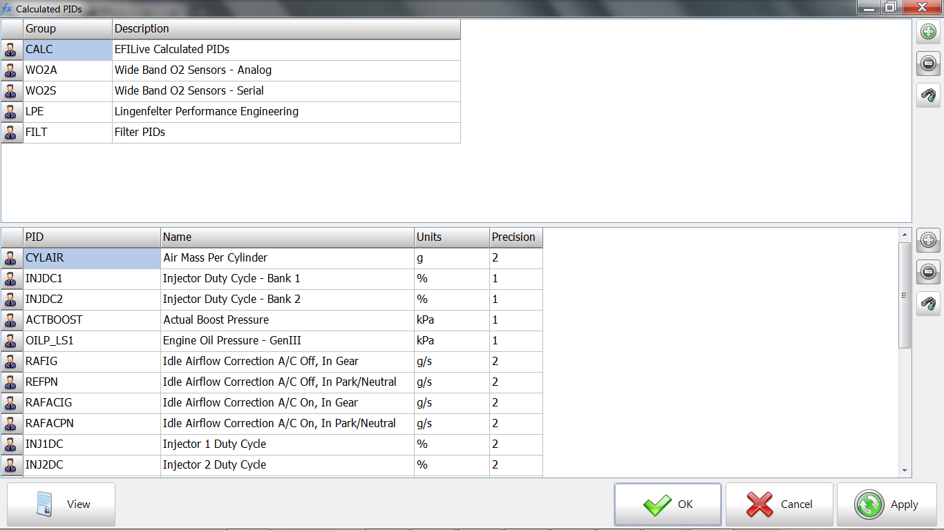

Why not just use the built in Calc PIDs editor?
In the Scan Window, click the drop down arrow on the [Options] button and select "Calculated PIDs" (or just use the Ctrl+K hot key).
Calc PIDs in data logs are updated instantly (when you close the calc pids editor, or click [Apply]) , no need to try and understand/edit the calc pid *.ini data files.
You can also export/import calculated PID groups to easily share your own calc PIDs with other users. Just right click on the group's icon and select import or export.

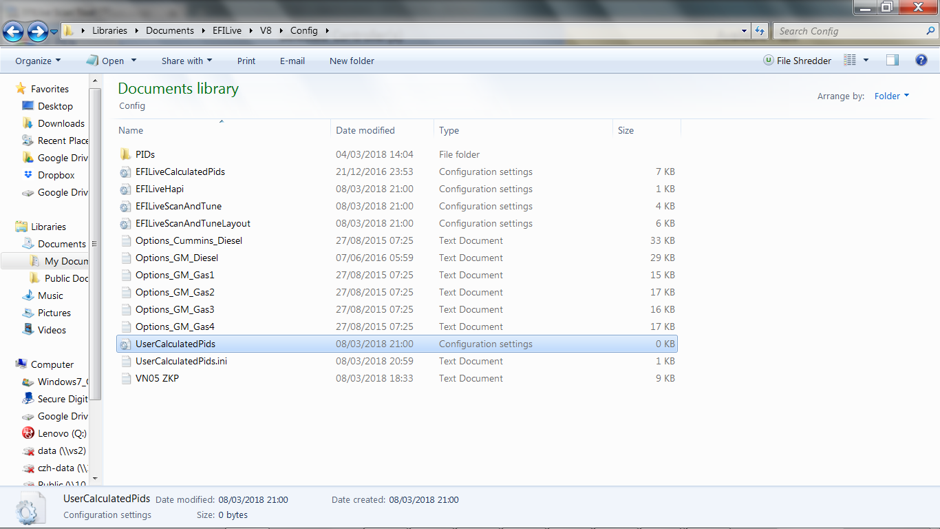

Hi Joe, which folder does this attachment reside, i put it in C:\Users\Andy\Documents\EFILive\V8\Config. I cant see the pids when i open V8 scan. I can manage calc pids in V7.5, need a push in the right direction![]()
Yes, the file UserCalculatedPids.ini correctly resides in that folder C:\Users\Andy\Documents\EFILive\V8\Config
When you open V8 S&T, click Scan, look over in the RH pane (yellow) Available PIDs, expand Calculated, you should see your pids here.
Post your UserCalculatedPids.ini file here, let me look in it...
