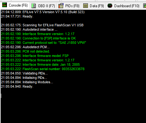

    and the issue is back. cant even flash a tune or read a tune. tried multiple pcms.....
    1989 Notch l Forged 5.3L l PT91.5 l th400
    SBE 4.8L l S475 l th400 8.62@156 (old setup)
    Mar 2006
    4,936
    Can you verify that the V1 powers up when plugged into the OBDII port only? It looks like the PCM isnt communicating with the V1, but your PC can communicate with the V1. Check your cigarette lighter fuse as well, it's connected to the OBDII port.
