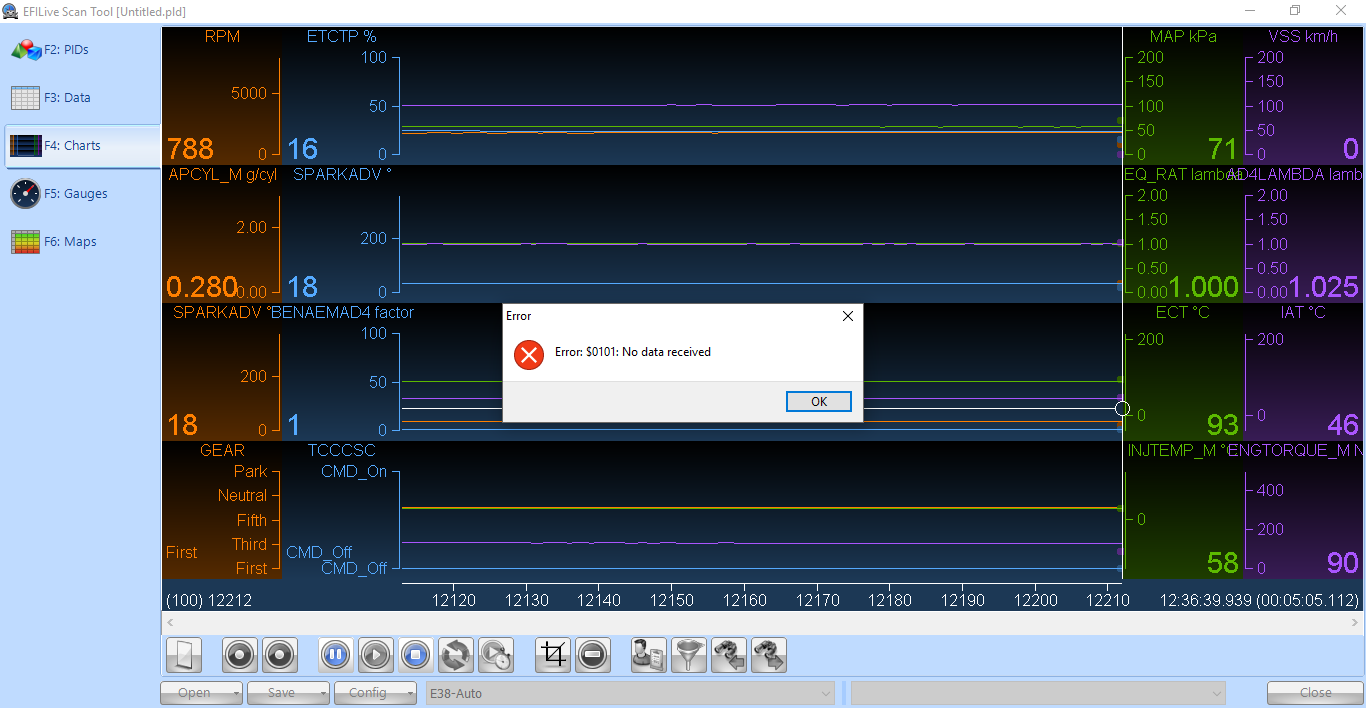

    This is the error i get while logging with v8 too.
