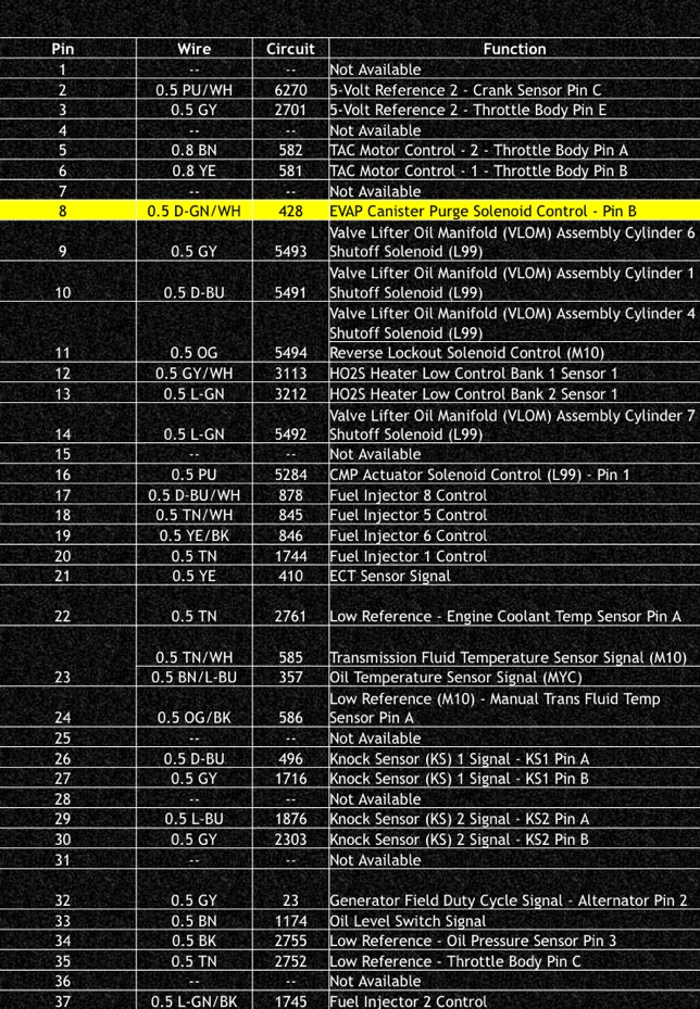

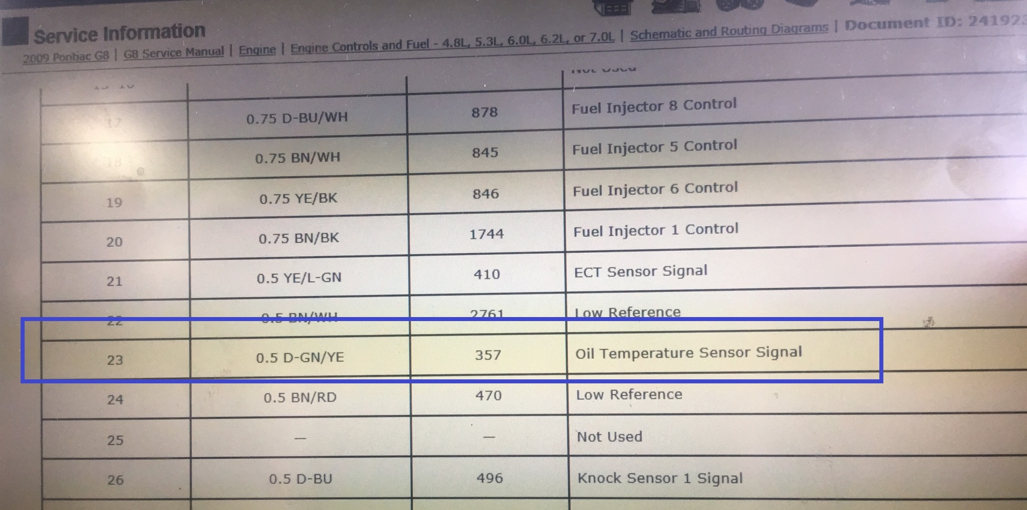

    I did find some clarification today to help understand these OS differences relating to pin 23. According to GM doc, the 2009 Pontiac G8 with LS3, [only came with an Automatic trans] uses Pin 23 for EOT signal. And so doesn't the 2010 Camaro L99 or LS3 ECM, however depending on transmission option.. But the 08-09 Vette only used the pin for trans temp with 6spd manual. With an automatic trans, that pin is unused. All Vette's used "calculated" EOT, so the pid values seen on any scan tool are calculated values with stock OS.
    I don't have 2009 G8 or 2010 Camaro file handy to look at, but I'll bet default setting in G1218 is "sensor." Please take a peak at those if you have a min.
    So question remains, how does that table G1218 actually handle the pin 23 and related canbus output values? My goal is just to nail down if we can use EFIlive to activate that pin on any OS, no matter it's default setting. That would allow the other tables correct reference, and it reports true EOT ovr the bus. Or does everyone need to run a specific OS to take advantage of the sensor. Majority of my customer are doing marine swaps where a fresh water to oil cooler is used, and true EOT "should" be much lower than any calculated value in a car... I know this is also of interest to users who track race these cars and install aftermarket coolers.

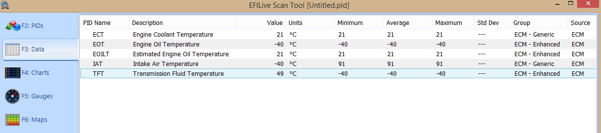

    After looking through several LS pinouts, OS version controls multiple pins on these units. Very versatile ECM.
    What's funny, stock OS 990 on the bench reports that EOT to pid like it's an OPEN circuit.
    While "Estimated" EOT tracks straight to ECT without an RPM or oil pressure signal.
    TFT pid reports as expected in stock OS when pin 23 is wired to a POTs.
    Hopefully I'll get time to try those other two OS listed also...
