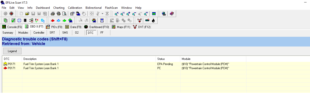

NOT STOCK - FILE PULLED FROM ECU - NO LTFT.ctzClick image for larger version.
Name:	P CODES.png
ID:	21689LOADED - VARY THROTTLE.efi

When I go towards WOT, the car just goes SUPER rich and throws a check engine for "lean bank 1" (See attached)
So, the ONLY thing I'm noticing is that it does NOT have a second 02 sensor installed or plugged in. It does have the wiring for one, though.

If you watch the datalog, you'll see that the 02 is throwing in a BUNCH of fuel like it's going into some sort of "Limp Mode". My wideband does show the event, so it's confirmed.
Does anyone have any idea on this one?
