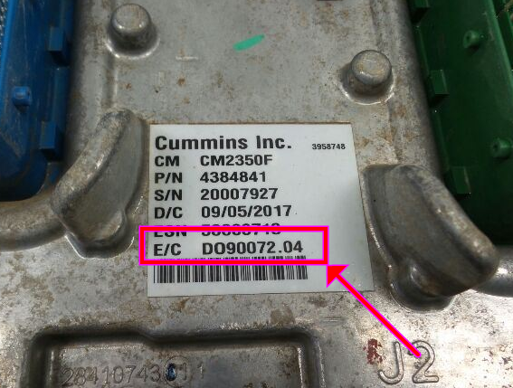

    Firstly identify what calibration came with the ECM, this can be found by looking on the ECM label. You are looking for the 'E/C' number as seen in the image below, this will make sure the source you are getting the tune file from is giving you the correct calibration for your vehicle.
    In the example below 'DO90072' refers to the vehicle specific calibration configuration and the '.04' is the fourth revision. Yours may have a different revision like DO90072.02 or DO90072.05
