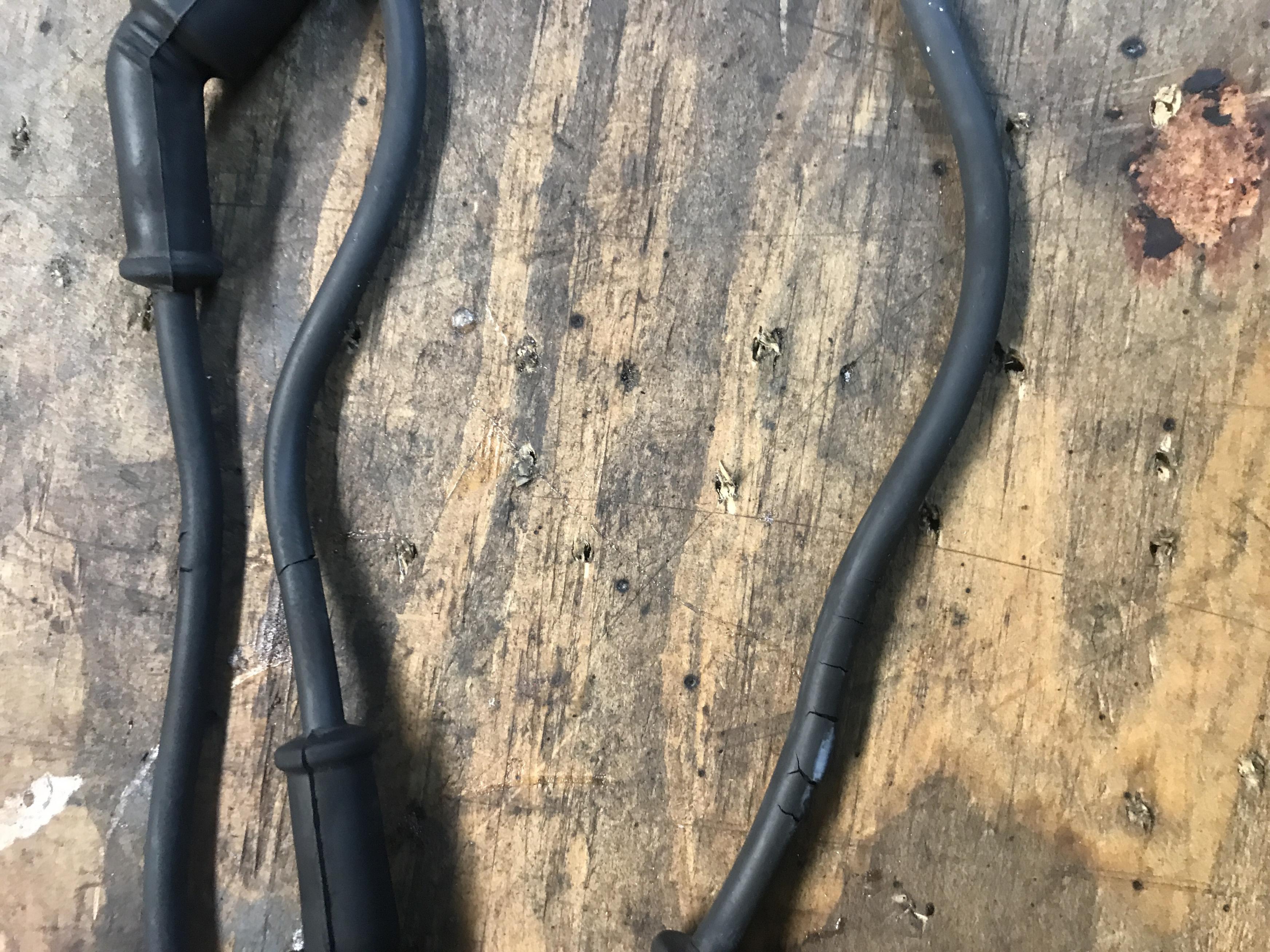

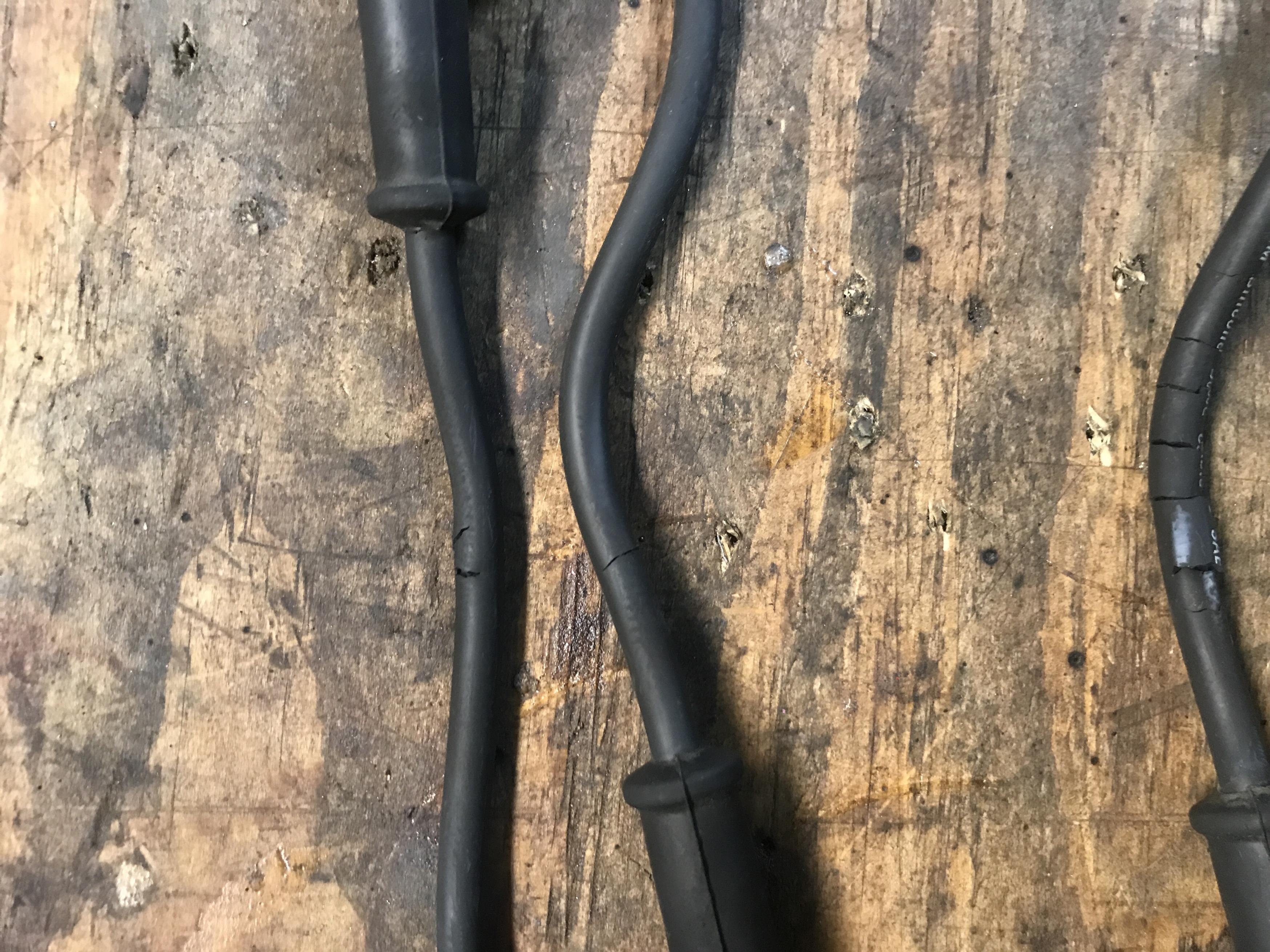

    Update, replaced the plugs and found the problem.
    Plug wires only have about 100 miles on them. Gonna have to reroute.
