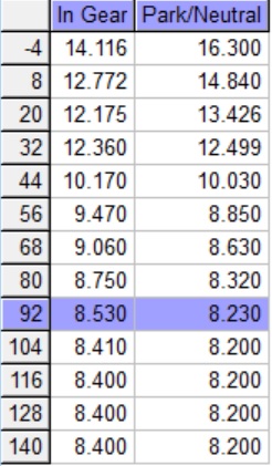

    Bearing in mind that it idles pretty well as it is, here are my RAFIG results and my current desired air:

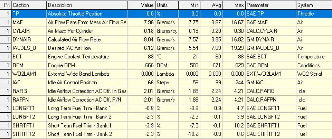

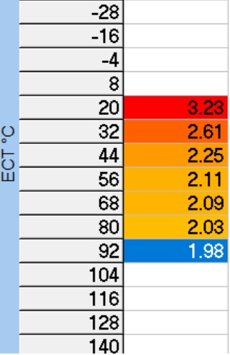

    And here is the actual measured airflow in gear:

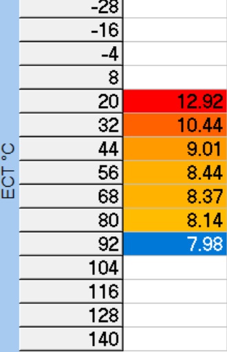

    I can't understand such a discrepancy and don't think adding this much air would be a good thing. I do notice when logging that the desired IAC airflow is significantly less than actual and also less than is in my desired airflow tables:
    Are these things connected, and do they make sense to any of you?

    I just read a post on the idle tips and tricks thread where 5.7ute speculates that rafig is something to do with the way the pcm uses IAC effective area to calculate airflow. This makes sense to me.
    Aug 2013
    735
    We went through this 2years ago....
    https://forum.efilive.com/showthread...d-airflow-rate
    Junior Member
    May 2015
    36
    Quote Originally Posted by statesman View Post
    Not exactly although it seems that effective area is a factor. I experimented with it back then and in the end returned to the stock settings in that table because it ran better with them. Since then I've gotten pretty close with my idle issues, it doesn't have the idle hang etc. but since the airflows don't match and rafig seems off by the same amount I have to wonder why.
    Aug 2013
    735
    RAFIG only works when your airflows all line up. To get them to line up, you need to adjust your IAC effective area. That's the reason that the table is there... so you can 'tune' the correlation between IAC and airflow. It allows you to correct for changes you make to airflow like when you crack the throttle blade... it's how you re-align your calculated IAC airflow to match the actual airflow.
    You'll never get anything useful from RAFIG while the airflows don't line up.
