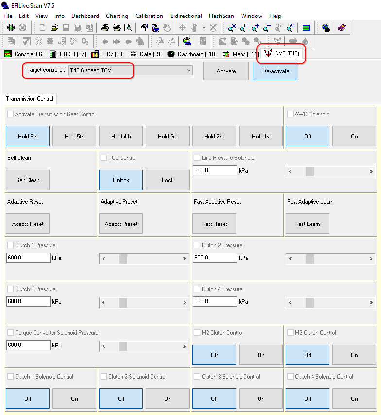

    Good Morning EFILive Team,
    I am in hopes that the engineering team has the possibility of adding a new feature. It would be great to able to command the individual solenoids (and/or the correct combination of said for a particular gear) on the 6L80/90 T43 Tehcm.. It would be a great addition to the Scan Tool as well to be able to 'hold' the trans in a particular gear / command TCC on and off.
    I am willing to test any Beta available with this feature. I have access to -many- different t43 Os Groups, but mainly Trucks (not only diesel applications). Thank you in advanced.
    Mar 2003
    9,505
    Have you tried using the DVT (Dynamic Vehicle Testing) controls in the V7 scan tool?
    Or did you mean in the V8 scan tool? The V8 scan tool has not yet had the DVT controls added to it. That will happen in a future release of the V8 software.

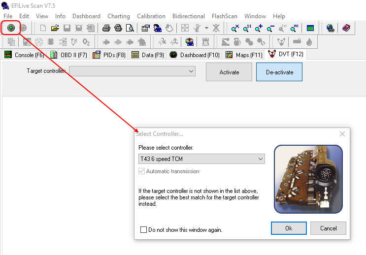

    Sweet! Wow I feel stupid, I never actually opened Scan 7.5, only Scan 8.0 and Tune 7.5
    So what are the minimum controllers required to get this to work? BCM ECM and TCM? I have a ECM TCM set up with the Bench Force harness right now but when I click "activate" I get "Connect to Vehicle Prior to using the DVT Control Panel" error.
    Mar 2003
    9,505
    In V7 scan you need to click on the "Connect" button to connect to a single controller (i.e. the TCM) prior to logging or using the DVT controls.

    Nevermind i was connecting to the FlashScan/AutoCal Only instead of connecting directly to the T43. Everything works!! Thank you Blacky.
