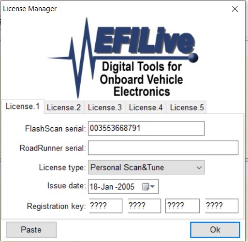

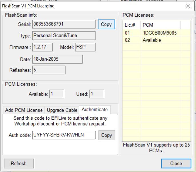

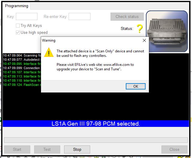

    It's been a long time since I needed to use my EFILive v1.2 to do some work on my 1998 Pontiac Firebird with a LS1A. But, the head/cam/injector upgrade now has given me the need.
    Since I no longer have my old laptop, I downloaded the latest EFILive v7.5. In the past, I was able to just upload, make my changes and flash with no other steps. Now when I try to flash my changes back into the controller, I receive a warning message that says "The attached device is a "Scan Only" device and cannot be used to flash any controllers."
    I bought the unit second hand and it has one license used and one available, but I shouldn't need to use a license for a LS1A, correct?
    Do I just need to register my device? If so, how do I get the registration key?

    Mar 2003
    9,490
    FlashScan V1. "Personal" version is no longer supported. I've emailed you a free upgrade to "Commercial". Let me know if you don't receive it.
    New Member
    May 2007
    6
    I received the email. Everything seems to be working again.
    Thank you very much.
