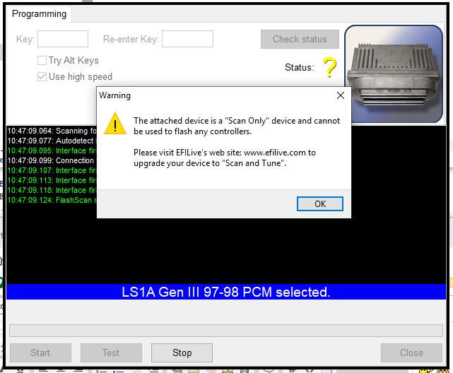

    I have not needed to change my tune in a long time. As I no longer have the old laptop, I downloaded the latest v7.5 build.
    Everything was working as expected until I went to flash my new tune to the LS1A in my 1998 Pontiac Firebird. This is when I received a warning that my device is "Scan Only".

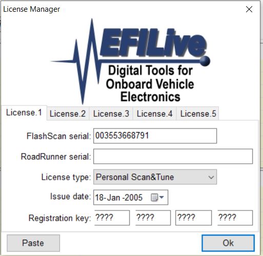

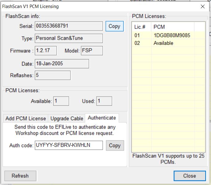

    From other posts, it sounds like it might be a licensing issue? My current license is a Personal Scan and Tune and I gather that it those are all expired?
    Can anyone help me out?

    Re-enter your license key and all information from your blue card exactly into the licensing window. The screenshot posted looks to be the generic license with perhaps your FS serial number.

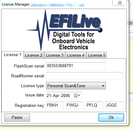

    I re-entered my license info and same result.Click image for larger version.

    I pm'd Paul.

    Paul sent me an email and everything is working again. Thank you very much Paul.
