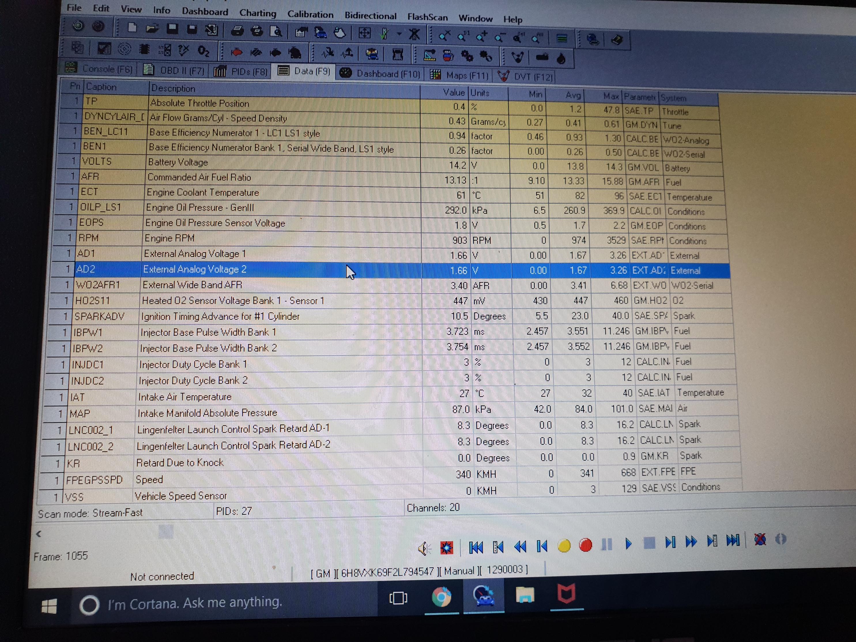

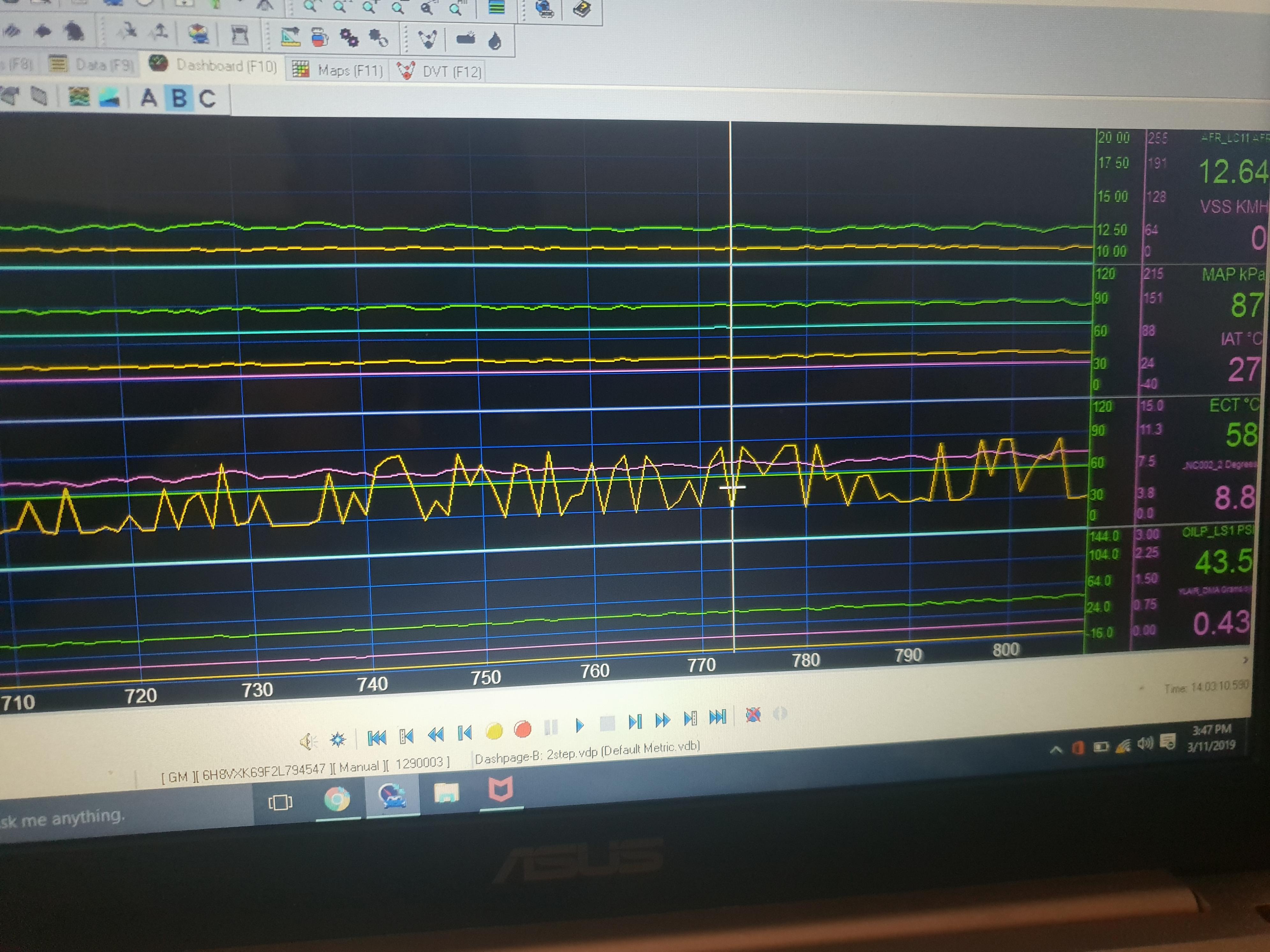

    Does anyone know a solution as to why the flashscan v1.2 is logging ad1 and ad2 as the same voltage and mimicking each other and causing ad2 to read wrong?
    Does the same thing even with nothing connected to the ad2 input!
    How did you wire up...?
    New Member
    Nov 2019
    4
    signal from my innovate lc2 in the ad1
    common ground to chassis in the 2nd pin
    and lentenfelter lnc002 5v output to the ad2 pin
    So you have the ground from the LNC002 and the ground from the LC-2 connected together and to the middle pin on the FSV1...?
    Are you sure they are both grounds...?
    Disconnect the ground connection from chassis, use actual grounds from each device.
    New Member
    Nov 2019
    4
    they both are running off the single common ground (to the same point as the lc2), they both register different voltages off this earth, and the lc2 also still works without a ground hooked up to the v1.2.
    the LNC002 is earthed via the coil pack harness. do you think this will be the issue? simple as just joining the 2 earths on the centre pin of the v.12?
    Quote Originally Posted by olmatey88 View Post
    Is this ground connected to vehicle/chassis ground...?
    Try this.
