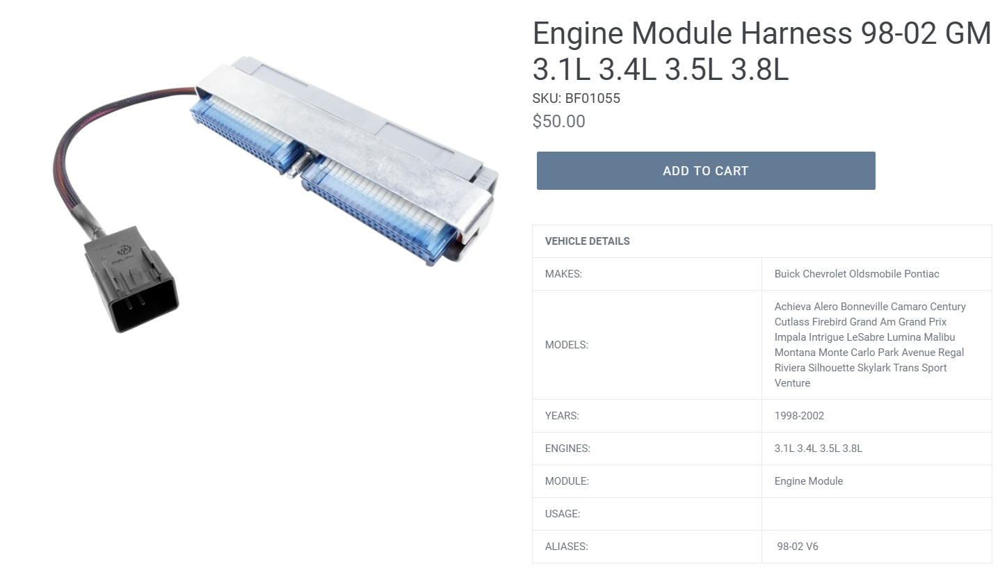

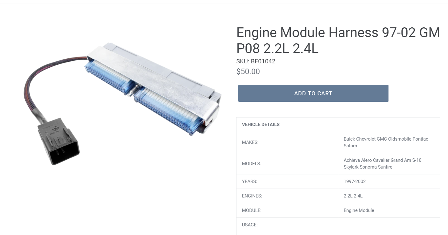

    Interesting... I will try again and count the pins on the LS1B Connector instead of the ecm.
    Oddly if I connect a V6 Buick to my LS1B harness it will blow fuses immediately. (Using a older Kent Moore bench harness)
    Connecting to this Cavalier one and it back feeds power to the key on circuit.
    EFI Connection sells a seperate harness for all these for this reason

    My harness had to many wires. I simplified it down and works. You was right as normal... Thanks for the help.

    Yeah that's the trick, those four wires I mentioned are common for all those PCM's that look like that.
