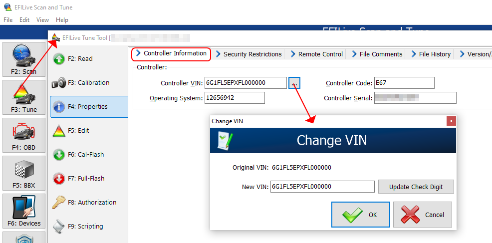

    Quote Originally Posted by S10Wildside View Post
    In the V8 software, I'm able to read the controller and then get to the VIN change screen. I can change the VIN shown in the text box, but then I see no option to program the VIN into the controller. I've tried saving the file, and performing an update and full flash. Nothing changes the VIN.
    What am I overlooking? Same issue with the T42 TCM.
    It appears that you may be only changing the VIN that is stored in the tune file. This option only changes the VIN that is stored in the tune file, not in the ECM.

    The VIN stored in the tune file is for display/information purposes only, it is not programmed/updated back into the ECM when the tune file is flashed into the ECM.

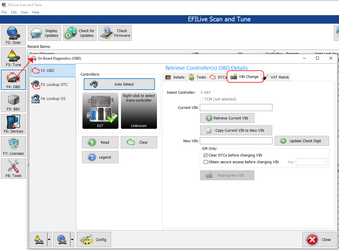

    To change the VIN in the ECM/TCM using either V2 or V3 devices, use the "VIN Change" option in the V8 software:

    See post #3, the second image.
