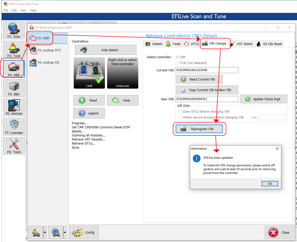

    I have been using EFILive for several years and started working on 19-21 Cummins. I have a customer that needs to change the VIN on his ECM. I have tried with 7.5 and 8 Scan to avail. I know bidirectional doesn't work like the older Cummins, I get a Sub-Function not supported. I have a base file and Iam able to flash. ECM is licensed. Can anyone tell me if it can be changed and how? Seriously appreciate any help.

    Does this not work?

    Does this not work?
    Like a champ.. Thank you.
