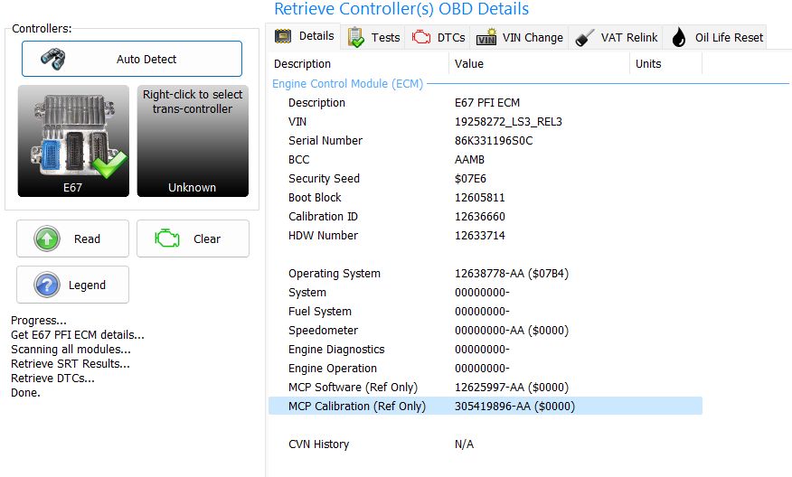

Now I'm up to the wiring and programming/setup of the T43 and E67 to work together. I have the wiring all sorted but I'm not sure if the OS on the E67 will work with the T43. Below is a screen shot of the E67 details:

Apparently the T43 has been pre set to work with this E67.
Does anyone have a stock cal file for the above E67 LS3 for use with an auto?
