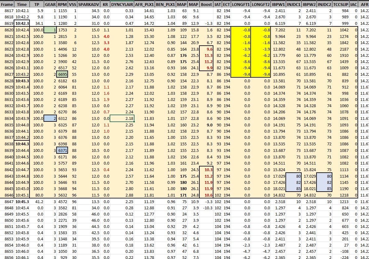

    First time I've been able to tune consistently because it broke every 4L60E or build I put in. Now that the 4L80E is living, I got some hurdles.
    1. I got some LTFT's going into WOT
    2. Tip into boost always hits lean for a moment
    3. 50 to 60% throttle (close to boost) was rich 10:1... I began to get away from that, but still struggling
    4. I usually have KR in 1st gear, but barely any when rolling and hit from 2nd gear.
    5. I finally got more consistent mid 11's for AFR. It seems to like mid to upper 11's.
    6. I change from dual Walbros to single Hellcat and upgraded Boost referenced FPR with bigger bowl and 8AN return.. and 8AN Rails
    Any advice would be appreciated. Here is some data.

    Post IFR, VE, and PE tables.
    ( or post your tune file file and some log files )
    LS1B_0796_240207_VE_VBE_Mechanical Blvd.efi
    240207_VE_VBE.ctz
    This is the one where I basically spun through 1st, 2nd, and most of 3rd before backing out of WOT. (ctz and efi files)
    There is plenty of driving data in the log file

    I have P305/R19/35 Mickey Thompson ET Street S/S on the rear.
    I know there is not a lot of WOT data. To really move forward, as if racing on the street, I can only give it about 3/4 throttle.
    When I WOT, it spins as long as I hold the pedal down, even when I feather it. (I guess that's a good problem to have, in a way).
    I am going to put a methanol kit in and then go to the Dyno, then to the track so that I can get some hookup and real data.
    I'm running Race Gas Additive right now to avoid all but some spurious KR.
    I'd rather be blown, bored... AND stroked!
