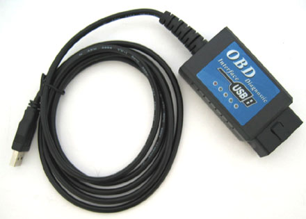

Which OBD2 cable do you have...?
Do you have the GM Service Manual for your 2003 GMC Envoy (this is required for diagnosing problems)...?
Have you done mechanical work on your 2003 GMC Envoy (you must be familiar with general procedures/methods/tools)...?
this cable :
and i have the service manual for the envoy from 2002 to 2009 in one manual ,

Did it come with software...?
Is it ELM327 compatible...? If it is, Google "ELM327 software".
