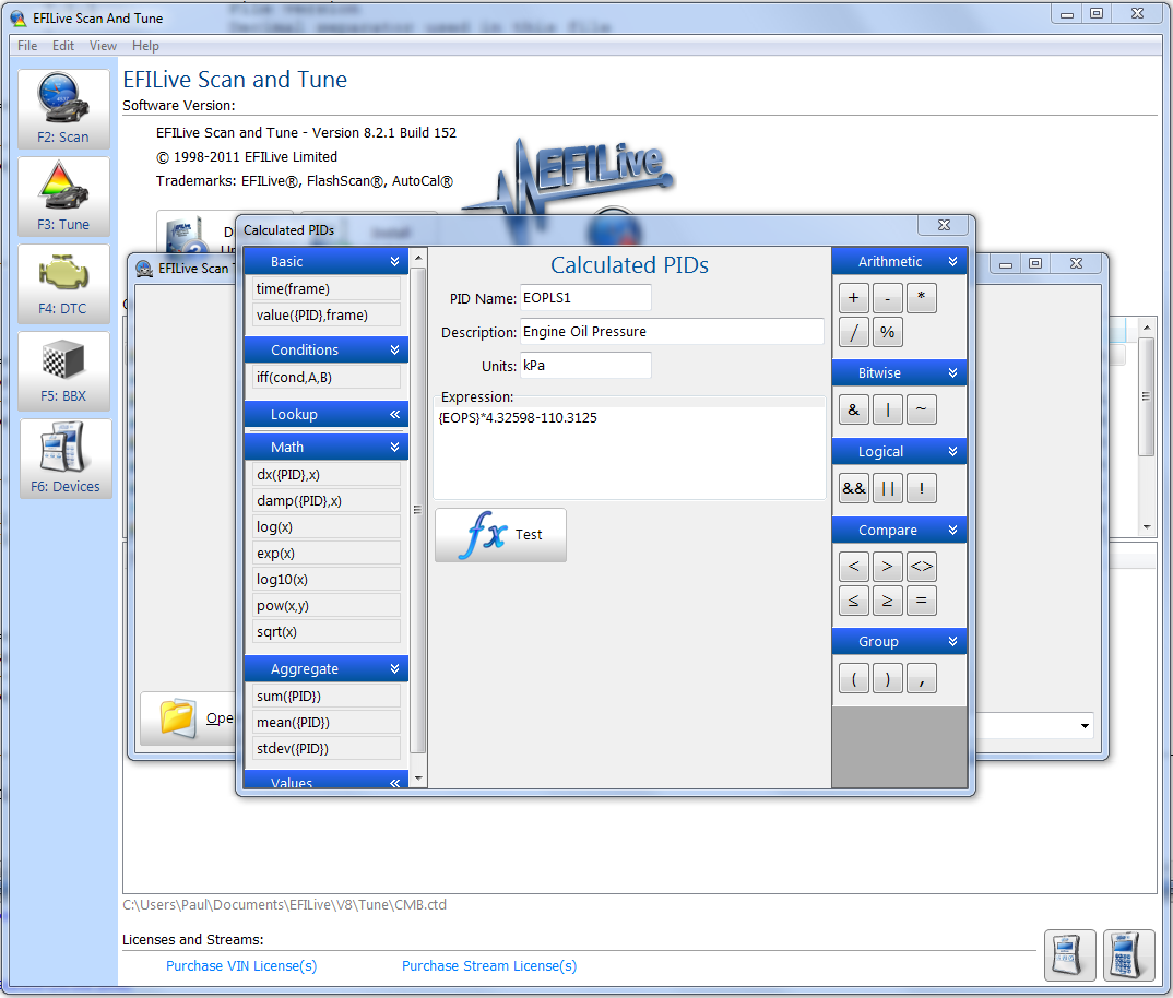

    Seems like a calculated PID editor is popular, see screen shot for what it will be like.
    Note: The V8 software is still under development and won't be released for some time yet.

    188
    mmm thats hot. I hope the ability to add PIDs based on their offset will still be available in V8

    Seems like a calculated PID editor is popular, see screen shot for what it will be like...
    YES! Everyone's life will be happier when you don't have end-users screwing with config files lol.

    Appreciate your comments, very well said. Both ideas you've described above are very important to the V8 design and development.
    The V7 scan tool configuration was never really designed, it just sort of expanded along with each new software update and each new added feature.
    Because V8 is a green fields development project we are able to capture the configuration in such a way that it will be a relatively simple process to share Scan Tool PIDs, dashboards and other configurations.
