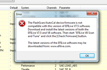

  10. #160
    Junior Member
    Mar 2018
    12
    OK I finally figured out the PIDs. Now when I try to connect I get the following error. Can V7.5 still be used somehow?
