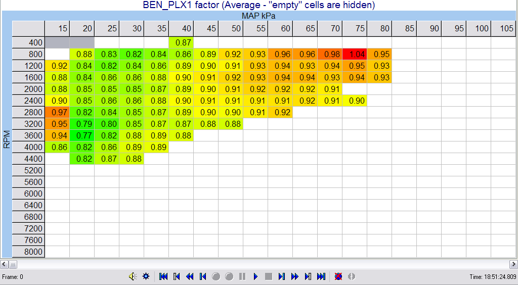

    The first map image I posted is hosed, some how. Applying the TPS/ECT filter is ok but when I "hide empty cells" where a cell is considered empty if the count is less than 50 results in averages that are much less than the minimum for that cell. Anyway, here's the map using the same data if I don't hide empty cells:
    Hopefully it's obvious to someone else what I'm doing wrong...

    There was a bug in a particular version (don't recall which off hand) that basically has a mathematical error in the hidden cell portion of the MAPs.
    From memory it hides 'n' cells (set as the number of cells to hide) from all cells still displayed. Then it does the average over the correct cell count and therefore the value is lower than you would expect.
    The issue is definitely resolved in the latest pre-release version, but I'm not sure which versions have been made publicly available.
    From what I gather the 7.2.3 version is due out any time now.
    Andrew

    Before I started today I upgrade to the June 9th pre-release of V7.2.3.

    Well that must be the version then (it's been a while)...
    I guess it is going to take an Excel spreadsheet until 7.2.3 is made generally available :(
    Not much conciliation but 7.2.3 will be worth the wait.
