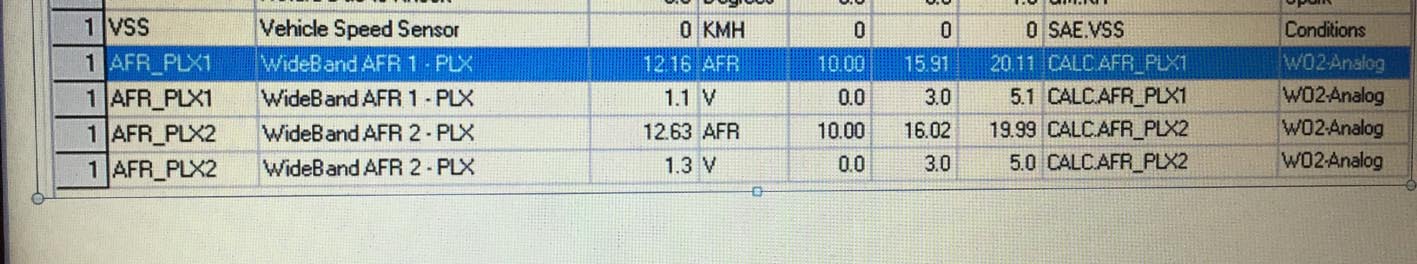

    I fitted twin PLX SM-AFR Gen4, Bosch LSU 4.2 sensors with twin gauges a couple of months ago (with help !), currently use the 0-5v analog output to feed into a HPtuners MPVI
    data logger...seems to work fine. I was hoping to use same way to connect to my Flashcan V2 when I eventually migrate to a EFILive tune. Have to say with my limited experience
    the response times look very fast.
    Stumbled accross this thread........are the analog signals really that bad ??

    Please can somebody point me towards the guide for setting up the analog 5v pids for plx wb's, specifically how to program the V2 aswell ?
    Thankyou.
