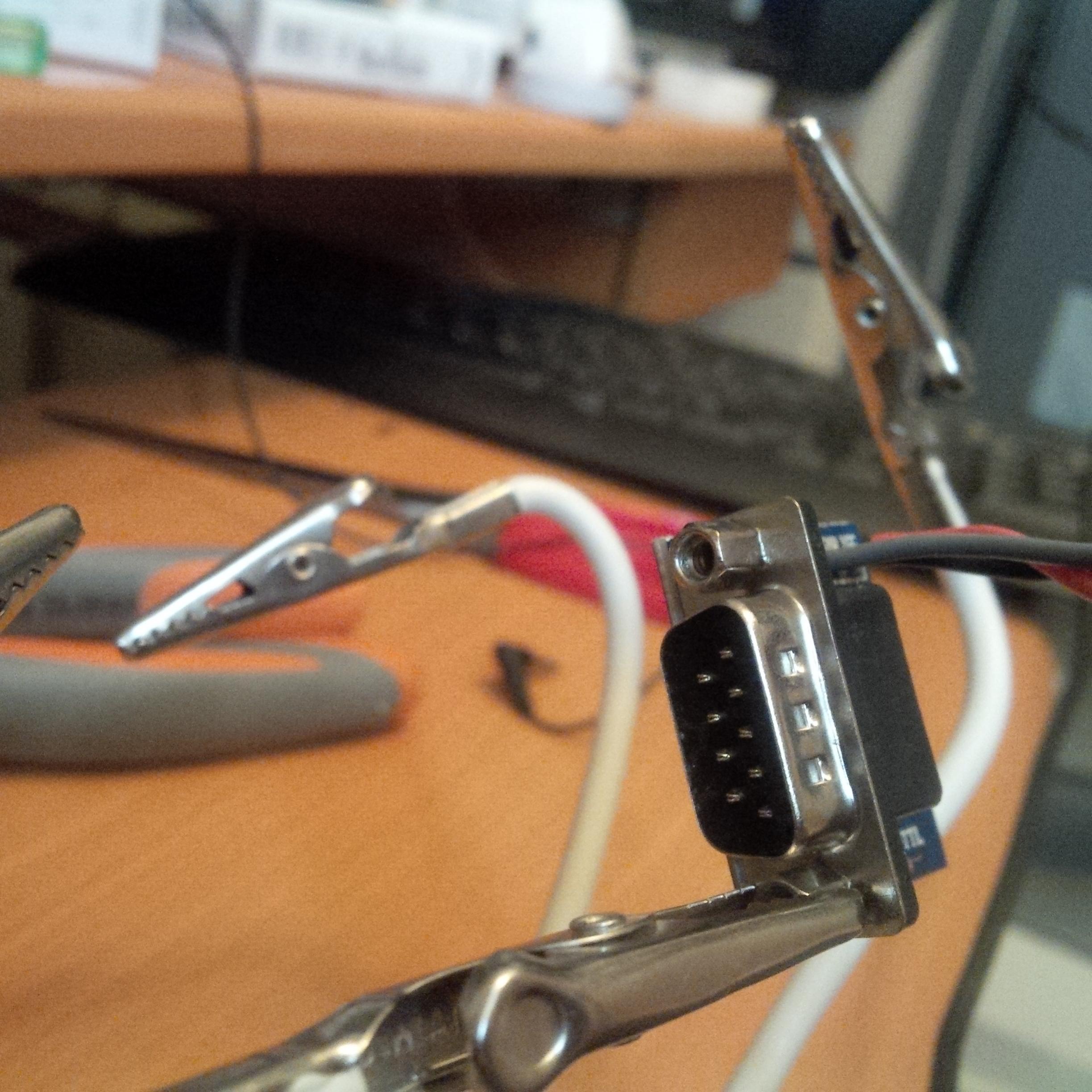

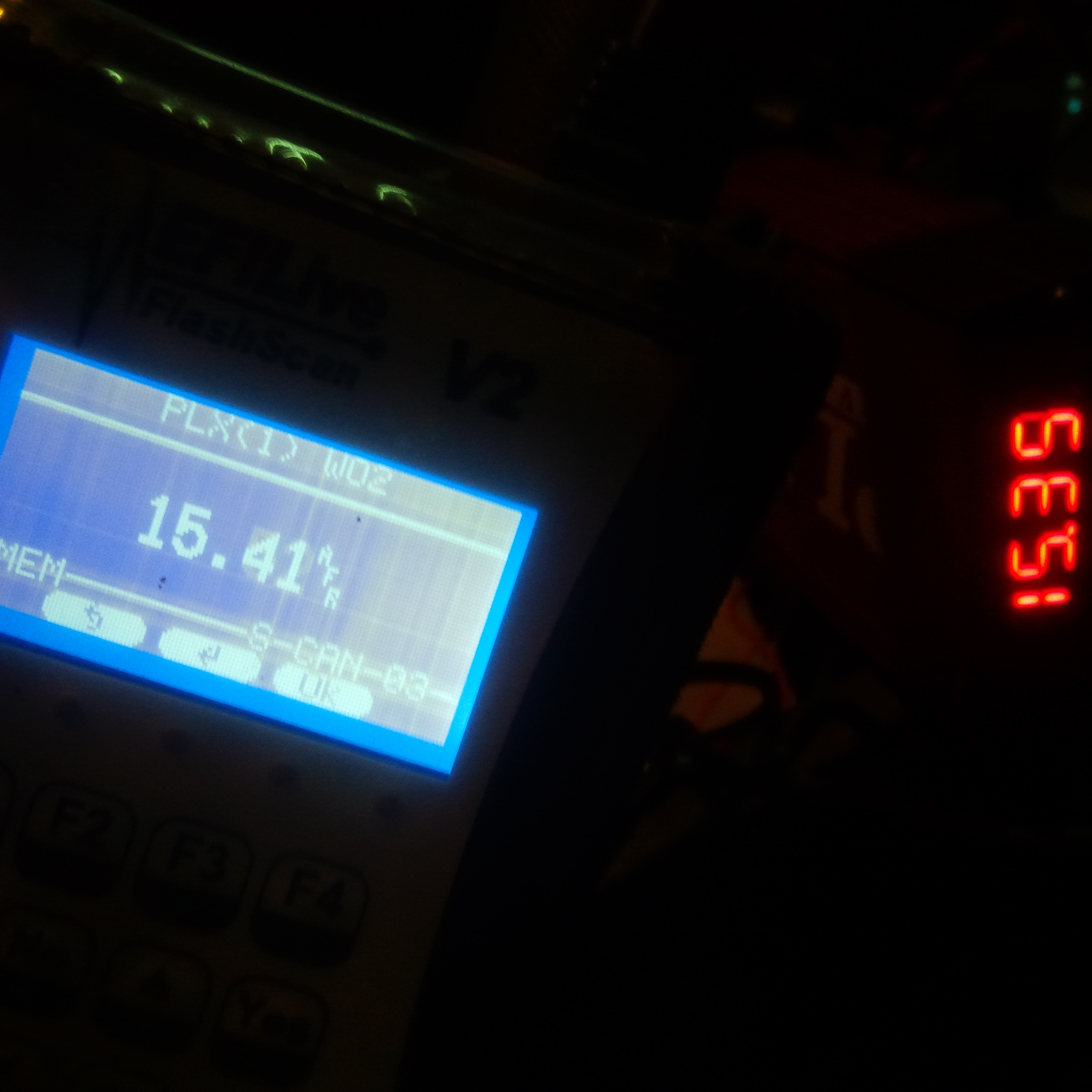

    I did the mod today and it was a breeze. Relocated the two components to make room and mounted the db9/max232 adapter to the back panel. used the cable that shipped with V2, cut the DB9 end off and replaced it with a male gender Db9. wired it so there's no need for a null modem (connected red to 2, black to 3 and white to 5) then configured v2 so it sees the WBO2 on the RJ12 jack. it worked the first try and couldn't have been easier! well, until they ship a TTL converter in the PLX. lol

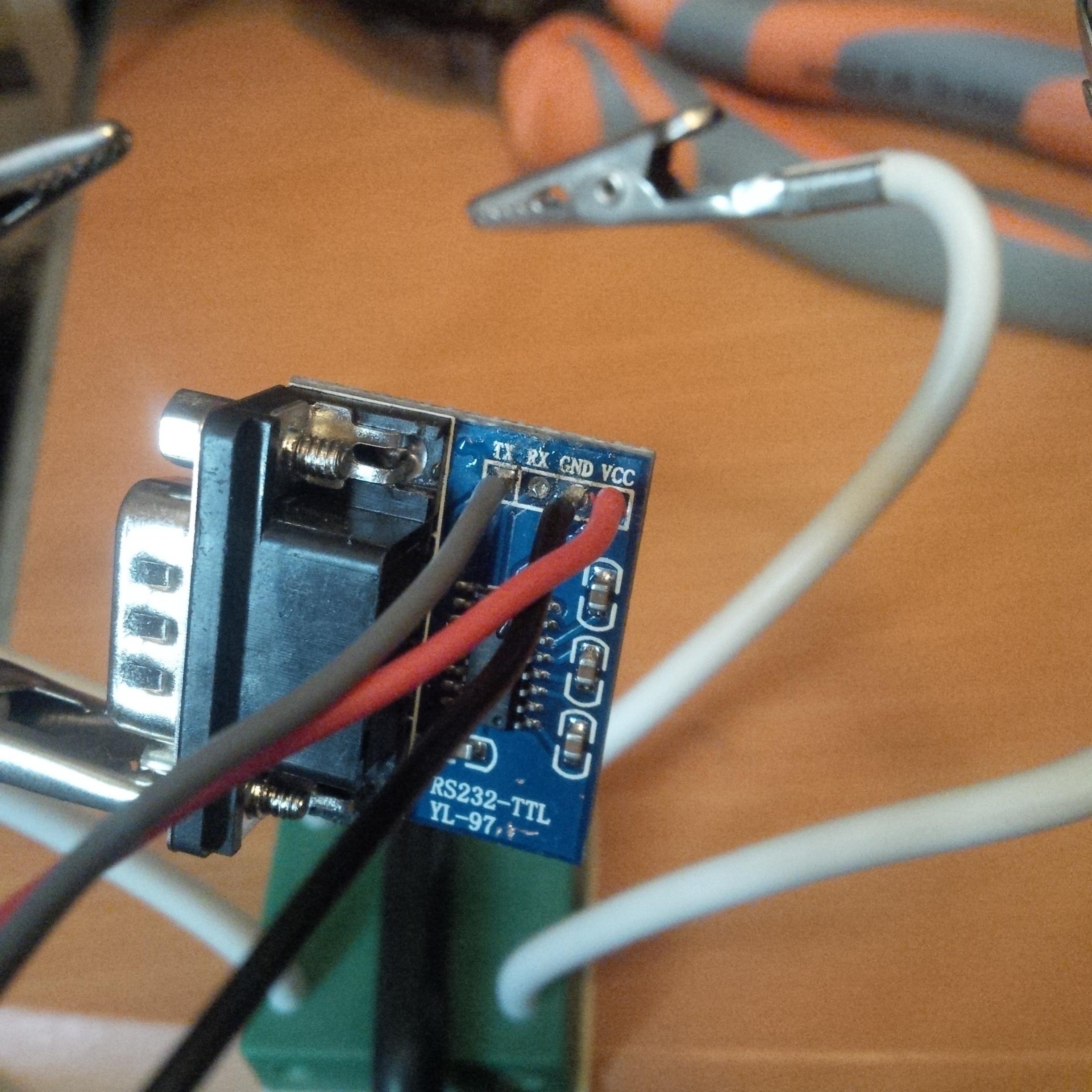

    Well i ordered the rs232 board from here. http://www.nkcelectronics.com/rs232-...33v232335.html
    then use a gender bender and cut my efilive cable to modify the pins. But if you used a null-modem adapter you wouldnt need to cut the cable.
    then i use the old Analog cable that used to plug into computer cd-rom drives (it's a 4 pin adapter) and then use that on to my board.
