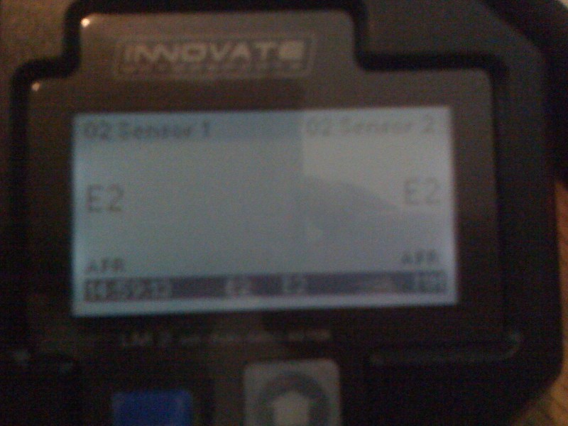

    Edit: LM-2 cables are now available for sale
    LM-2 ----> V2 RJ-12
    Pin 1 -------> Pin 1
    Pin 2 -------> Pin 2
    Pin 3 or 4 ---> Pin 5
    __________________________________________________ _______________
    LM2 ----> V2 Serial Cable ----> V2 RJ-12
    Pin 1 -------> Pin 2 ------------> Pin 1
    Pin 2 -------> Pin 3 ------------> Pin 2
    Pin 3 or 4 ---> Pin 5 ------------> Pin 5
    Attached photo's:

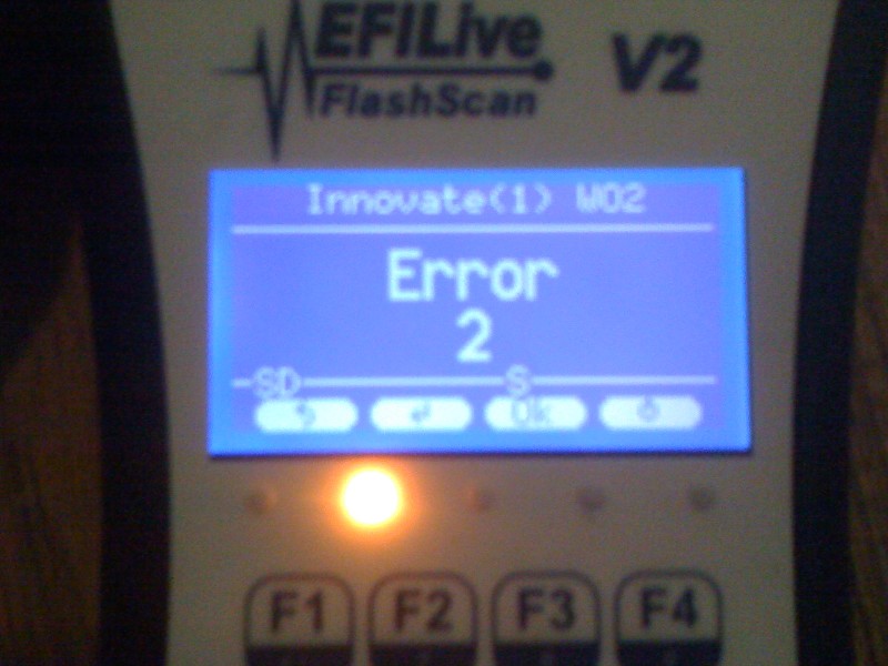

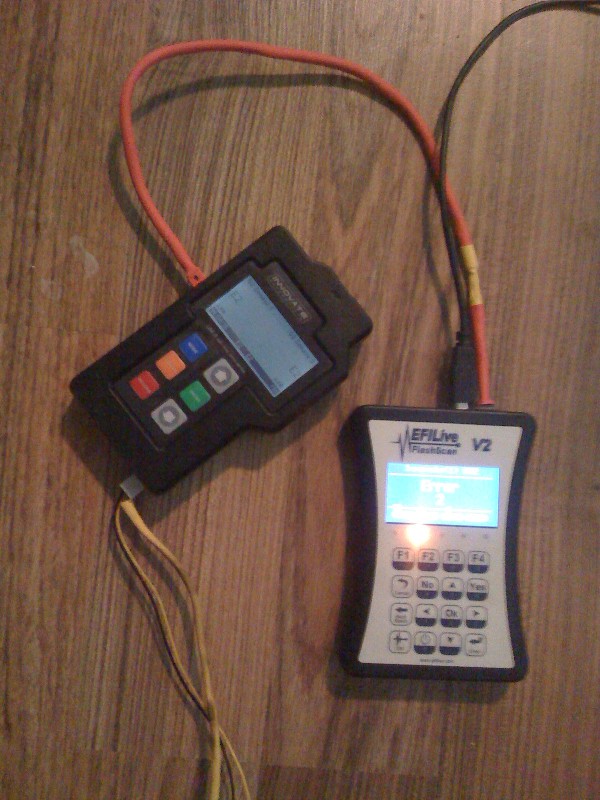

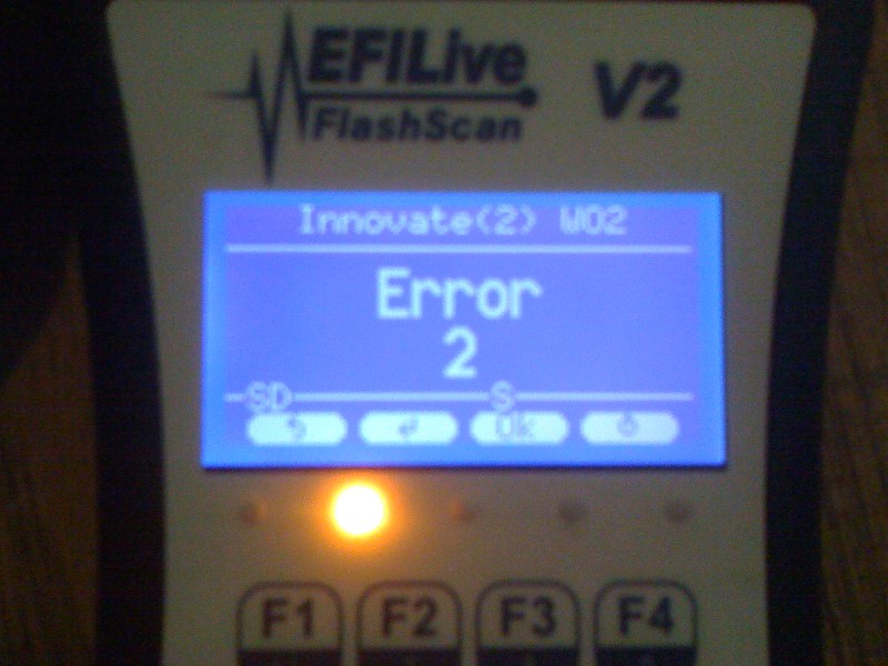

    1. V2, LM-2, and my prototype serial cable
    2. LM-2 display indicating both WB channels are in E2 - No sensor
    3. V2 displaying LM-2 channel 1
    4. V2 displaying LM-2 channel 2

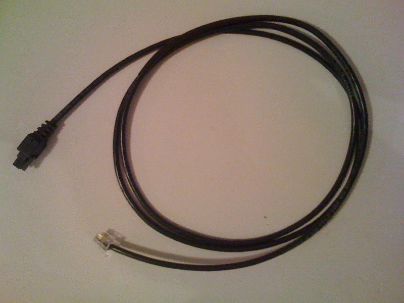

    5. TAQ Cable sLM2 cable

    no sir. My gheto cable oringinated as a 10 pin Molex from a car alarm. Are you trying to fab an LM2 to LC1?

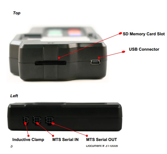

    on the LM2 side, how can I identify pin no. 1, 2, and 3?
    http://i298.photobucket.com/albums/m...infuse/lm2.jpg
    Regards,
    Odd Boy
  8. #8
    Quote Originally Posted by odd boy View Post
    See page 45 of LM-2 user manual
    the pin positions on the Molex plug are numbered.

  9. #9
    Junior Member
    Nov 2009
    19
    in page 45 they didn't point in a picture wich one is a RX and TX
    4. Serial Out
    Pin Use
    1 RX
    2 TX
    3 GND
    4 GND
    how do i know which one is RX and TX

  10. #10
    Junior Member
    Sep 2013
    11

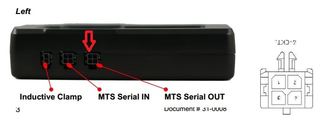

    As per the Molex datasheet;
    Pin 1 - Upper left
    Pin 2 - Upper right
    Pin 3 - Lower left
    Pin 4 - Lower right
    http://www.molex.com/pdm_docs/ps/PS-43045.pdf
