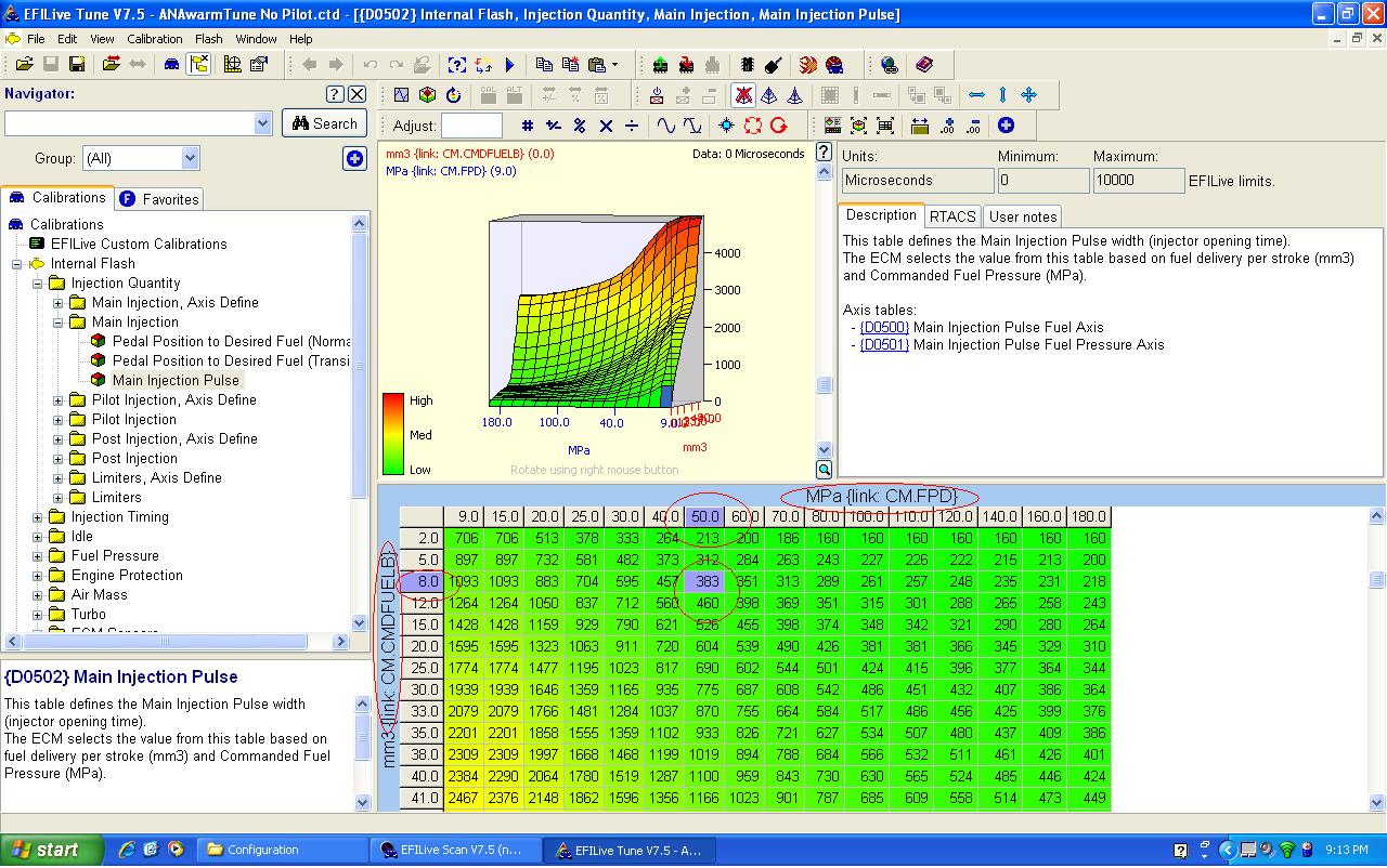

    ***Edit*** Update #6.1 Jan 9th, 2012 update
    Inside Update #6.1: Added the support for the following tables: Transmission Tables
    Note: Jan 31, 2012
    Disregard the linking feature in the Boost Fuel Limiter table F0502. It is linked incorrectly and should not be used a reliable link to ScanTool Data logs. Update soon to come.
    Ok, after downloading and following the instructions, you will be able to view what your data loggs are doing in the TuneTool. (provided that your log has the PID's [and in same units] needed for the table(s) you're wanting to view) For instance, if you want to view you Main Injection Pulse, open your data log in the scantool, then open you tune in tunetool, select what ever table (Main injection pulse in this example) and press play in the data log and watch a grey highlighted cell move around in the tunetool table and 3D graph of what the ECM is actually doing. See attached pic.
    Now this will be an ongoing process and updates, some from me when I get time, and some from EFILive when they do as well in Update Releases. Most of the tables are supported, but not all yet.
    Here goes:
    Click cal_link attachment>Save it to:>My Computer>Local Disk (C:>Program Files [(X86) if 64bit OS]>EFILive>V7.5>Configuration>Highlight "cal_link" text document>Save>Replace existing copy
    **Edit For 64bit OS instructions** (Hopefully this will make it easier for these folks with 64bit OS)
    If you do have a 64bit OS like I do on one of my computers, after saving the document, Open it in the "Downloads" window that it just saved in, then Save as: to the instructions above: My Computer>etc.>etc.> in the left lower window.
    That's it! Now do as instructed from above and enjoy the next best thing in data logging since sliced bread.
    Enjoy!
    -Andrew
    Supported tables: F0505, F0508, D0502, E0002, E0024, E0033, E0036, E0039, E0008, D0505, E0063, E0084, E0087, E0090, E0093, E0066, E0069, E0075, E0081, E0078, D0508, F0502, F0519, F0517, F0518, E2503, E2503, E2504, E2500, E2501, E2502, D6264, D6267, D6273, D6258, E0262, E0051, E0054, E0057, E0060, E0259, E0280, E0283, E0286, E0289, E0393, D0782, D0781, D0771, D0774, D0777, D0790, B7511, E2567, B4524, B4526, B4522, B4532, B4534, B4520, B4561, B4512, B4514, B4557, B4516, B4518, B4559, B4501, B4504, B4551, B4506
