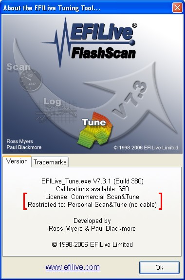

    If you have upgraded to an EFLive Commercial license, the following screen shots show the various authorization levels that the EFILive Tuning Tool software will use.
    The first image shows what you will see in the Help->About window if you DO NOT have your FlashScan cable plugged in BEFORE the software is started AND you have not entered your EFILive license details into the Help->Register EFILive window correctly.
    The second image shows what you will see in the Help->About window if DO NOT have your FlashScan cable plugged in BEFORE the software is started BUT you have entered your EFILive license details into the Help->Register EFILive window correctly.
    The third image shows what you will see in the Help->About window if you DO have your FlashScan cable plugged in BEFORE the software is started REGARDLESS of whether you have entered your EFILive license details into the Help->Register EFILive window correctly or not.

    Paul, I'm having a hard time seeing any difference between the images..

    Quote Originally Posted by MN C5
    You will see in the middle "License". Here in each of the pictures you can tell what it is set to. Demo, Personal, Commerical.
    Mar 2003
    9,608
    I have updated the images to highlight the differences.

    Mine shows the first image
    Without the cable it defaults to demo mode
    It seems to work fine with the cable connected.

    Quote Originally Posted by Beer99C5
    I had a similar problem, it would show demo mode after I had registered EFILIVE and the cable wasn't plugged.
    I double checked my rego codes and noticed my "ISSUE DATE" was wrong, that made all the difference, no more DEMO mode warnings when I start EFILIVE without the cable plugged in.

    Mine does the same thing and it never used to on the computer (that died) before I loaded everything on. Now on this new computer it switches back to demo mode without the cable plugged in and I cannot get it fixed it is dam annoying!!!!
  10. #10
    28,400
    Did you re-enter the info from the blue license card...?
