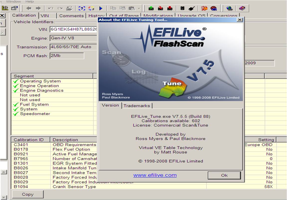

OB,
From the tunetool, go Help->About and post a screenshot.
here it is and I guess I got the problem, if I don't connect the interface it doesn't say commercial it says personal scan tool, looks like I need to connect it before I start the software. I'll try and come back to you guys.
Attachment 6197
This might help explain things...
http://forum.efilive.com/showthread.php?t=1936
