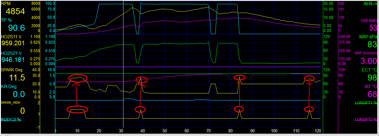

For example, the calc PID below returns 1 when the spark is >25 and 0 when it is <=25.
Attachment 14314
The calc PID is defines like this:

None 0.0 1.0 .0 "Iff({SAE.SPARKADV}>25,1,0)"
