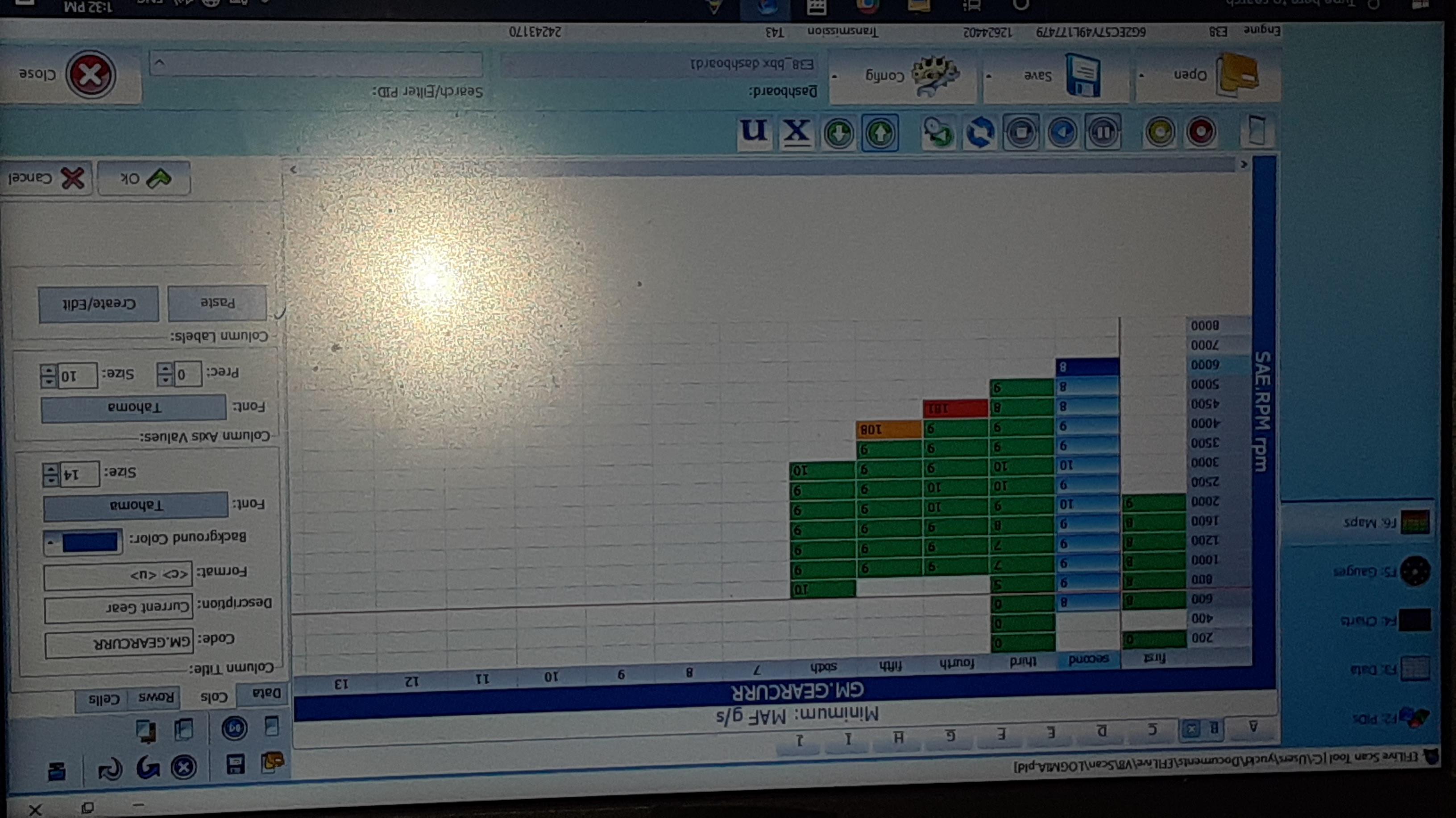

So I'm just reading this thread more and I'm confused do you set 1651 and 1652 back to factory after building the 1829 table out? I set up a map in v8...Attachment 23419

So I'm just reading this thread more and I'm confused do you set 1651 and 1652 back to factory afterbuilding the 1829 table out? I set up a map in v8...Attachment 23419

Do you put your B1651 and 1652 back to stock after tuning theB1829 table or...
do you leave1651 and 1652 slightly above your target idle and let it learn down
