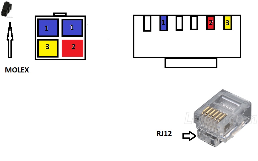

Hum???? Mine is close but 4 is NC, 5 is RED, and 6 is BLACK I just rang them out!!! ????? the colors in the drawing are just for reference

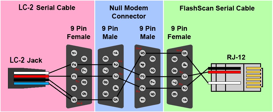

The LC-2 comes with a serial cable that has a 9 pin female and the V2 comes with a serial cable with the same 9 pin female ,
I went to Jay car and bought a 9 pin male to male joiner but can not read any data .
Do i have to cut one of the cables and re configure because the male to male adapter swaps everything around ?

I had to swap a couple of wires on mine to get it to work. It may have worked had I used a "null modem" adapter.
Ok i am starting to figure this out ,
Firstly i do not think the 9 pin male to male adapter i have is a null modem .
Secondly there is conflicting info on the correct RJ12 wiring between the 3 diagrams below
Attachment 17646 and this Attachment 17647 and also this Attachment 17648
So is it correct to say that the Red wire from the LC-2 goes to #1 on the RJ12 plug , white from the LC-2 goes to #2 RJ12 and black+blue from the LC-2 goes to the #5 on the RJ12 plug ?

In this picture the colors are not related to wire colors:
https://forum.efilive.com/attachment...8&d=1408419178
Molex connector pinout:
Pin 1 = Rx (white wire)(red cavity above)
Pin 2 = Tx (red wire)(yellow cavity above)
Pin 3 = Gnd
Pin 4 = Gnd
RJ12 jack is shown with an extra pin between blue and red.
LC-2 red -> FSV2 RJ12 pin 5 (black)
LC-2 white -> FSV2 RJ12 pin 4 (red)
LC-2 black+blue -> FSV2 RJ12 pin 2 (white)
https://forum.efilive.com/attachment...7&d=1392063599https://forum.efilive.com/attachment...6&d=1390471992
Thanks Joecar
I will try and make up a Molex to RJ12 cable and not use all the 9 pin stuff
