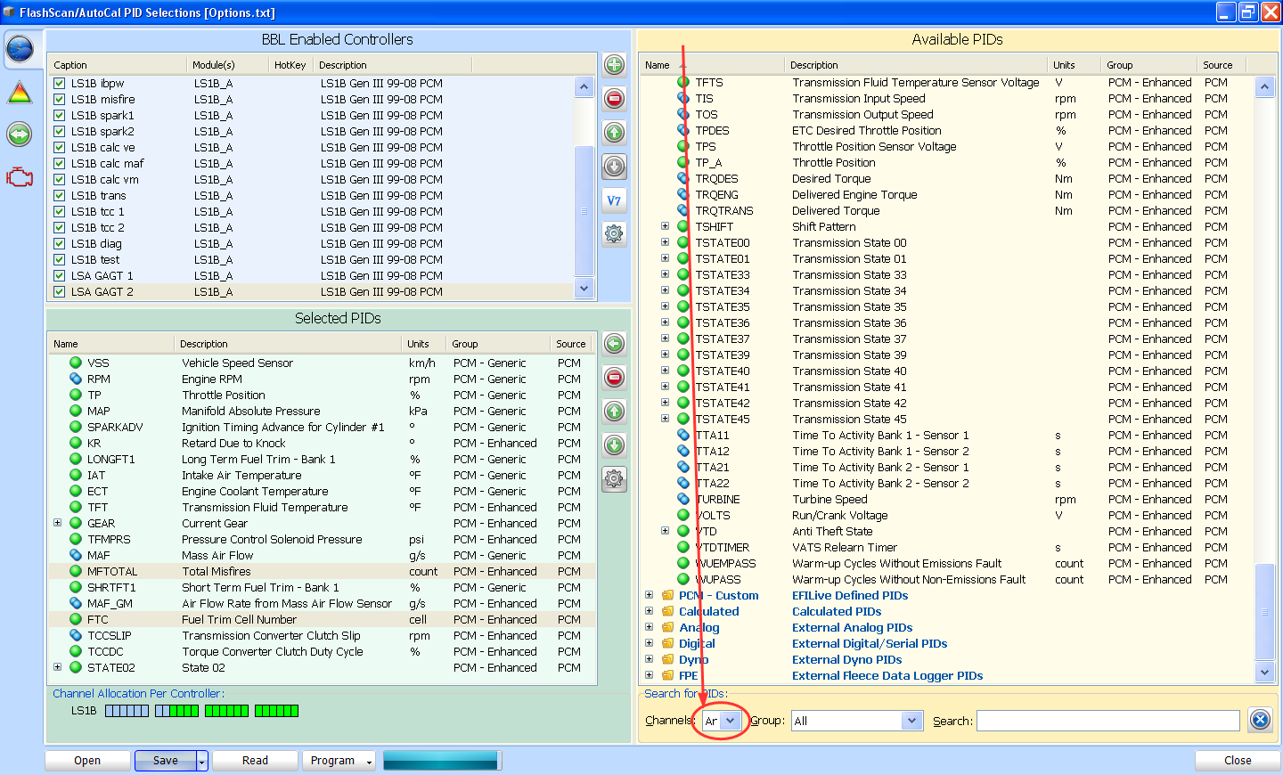

    • Increased pre-defined calculated PIDs per BBL PID selection from 8 to 32.
    [INDENT]
    NICE!
    Thanks so much for checking this out and better still adding even more
    Cheers, Chris

    Ok thought I'd jumped the gun a bit after reading the description that the added slots were in Firmware.. Have updated my V2 and am still not seeing the new PID slots..
    Is there a step I've missed? (newbie to this software/hardware so have made lots of mistakes)

    Same scenario as Ian. All upgraded and still only 8 slots in S&T bbl V7 settings

    Calc Pids file edit to use these maybe?

    Quote Originally Posted by IJ. View Post
    It just means you can still only define up to 8 calc PIDs in the V7 compatibility window but another 24 calc PIDs in the normal V8 PID selection (which can also have the same name as existing V7 calc PIDs).
    okay IJ, maybe not such a big problem,
    we'll have a look at your sae_generic.txt file and make some edits there to make use of the new capacity.
    we will just need to be very careful when you change versions

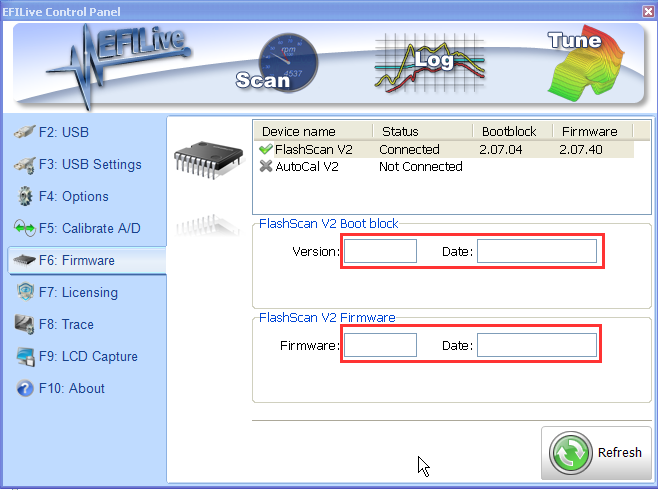

    Also, after updating my firmware to the latest .40, I clicked the Refresh button and fields stayed blank. I have a pin on my V2 so the first time after a firmware update I have to enter my pin and click Refresh to get the status update, but Ive never seen this happen before. I shut V8 down completely and re-opened it, still nothing appeared in the fields (but the FlashScan V2 line item updated correctly).
