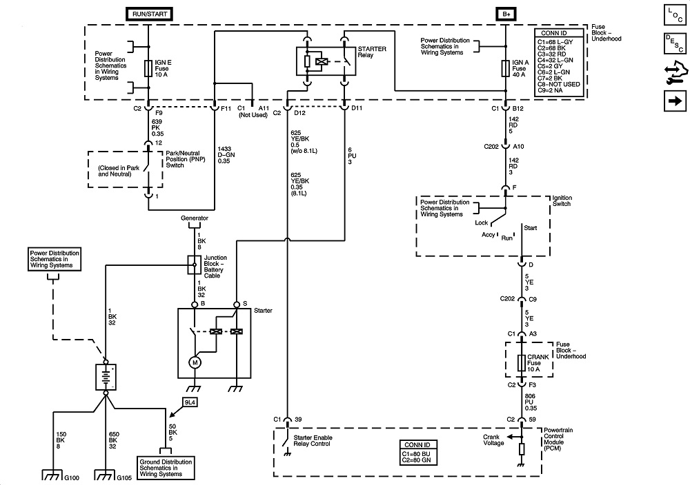

    Do you have a wiring diagram for your vehicle...? If so, post it here.
    Aug 2012
    239
    This is a similar diagram to how i wired up the starter circuit.

    Ok, I was incorrect... your PCM activates the starter relay... (interesting, BCM is not directly involved);
    For some reason the crank wire from ignition switch is reading 10.5V with key in run position.
    There should be voltage at the ignition switch START pin only when the key is in the START position.
    Is the PCM seeing residual voltage...? Test this by connecting a 2K resistor between the START wire and ground...
    if this fixes it then the PCM was seeing residual voltage, otherwise the problem is in the ignition swith and/or wiring.

    Ignition switch was ok, so I traced the crank voltage wire from the switch and noticed it split into two smaller wires. One went to the PCM and the OTHER went to snaking off somewhere up into the dash and who knew where else... so I spent some time at the library and that wire went to something called 'Diagnostic Energy Reserve Module' which was back feeding the 10V and causing my problem. I isolated that and everything works great now. Not sure what that module does... but it seems to only be active during 'cranking'?
    OK, this is what I found out on the DERM
    Circuit Description
    When the ignition switch is first turned ON, Ignition 1 voltage is applied from the GAUGES fuse to Redundant Indicator Ignition 1, terminal B2, and to the AIR BAG warning lamp which is connected to SIR Indicator, terminal B1. The AIR BAG fuse applies system voltage to the Ignition 1 inputs, terminals A9 and A10. The inflatable restraint Diagnostic Energy Reserve Module (DERM) Responds by flashing the AIR BAG warning lamp seven times. If Ignition 1 is outside of the normal operating voltage range, the AIR BAG warning lamp come on solid with no DTC set.
    When the engine is being cranked, Ignition 1 voltage is applied from the CRANK fuse to the DERM at the Crank input. The DERM responds by grounding the SIR Indicator output until Ignition 1 voltage is removed from the Crank input. This results in the AIR BAG warning lamp being on during cranking.
    After cranking, the DERM will flash the AIR BAG warning lamp six times.
