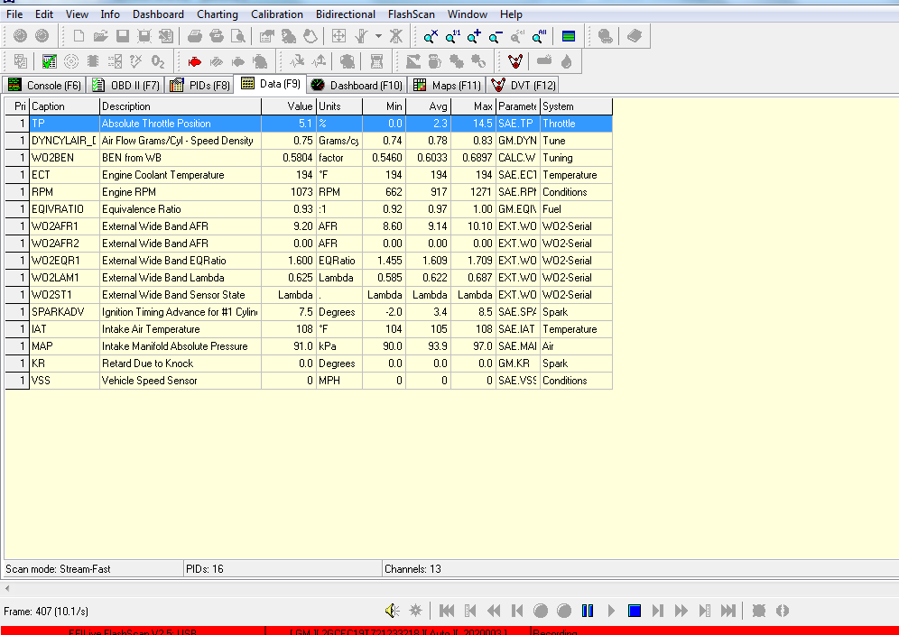

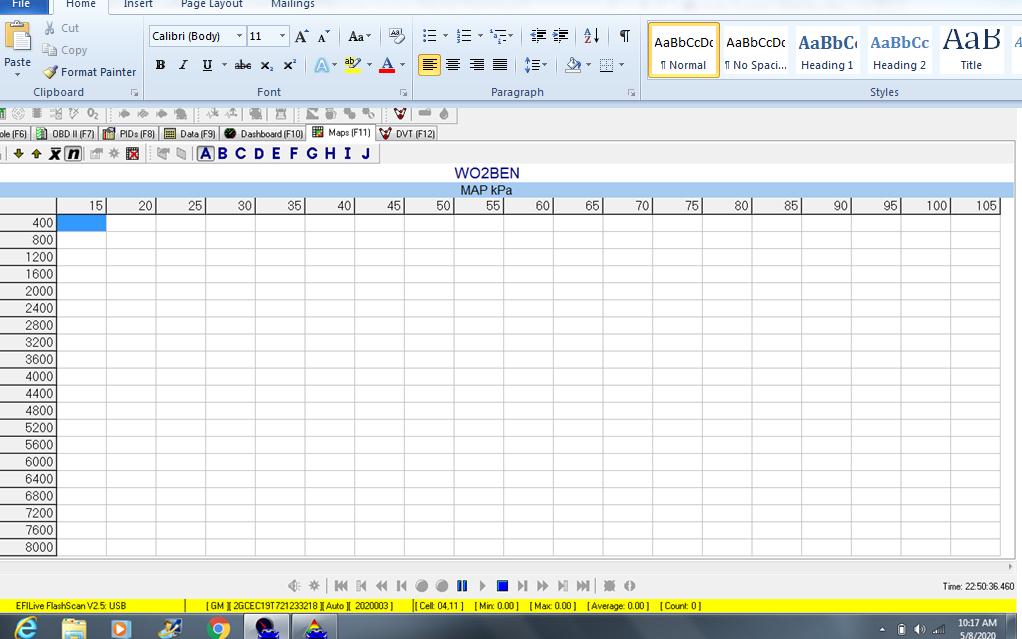

    OK I finally figured out the V7.5 issue. Now can anyone see why my map isn't showing anything?Click image for larger version.
ID:	23287Click image for larger version.

    Post a log containing MAP.
    Joecar, Thanks for the response. I finally got it. I had to switch the units from SAE to metric and back a few times and it started working. It has been quite the struggle with almost every step. I have done a couple runs so far and it is running much better. I might lean on you to look over my tune after I do a little more autotuning.
