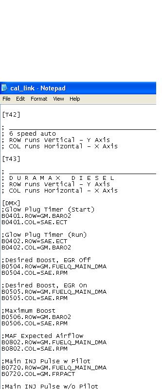

Ok, so how do I link them? And what do I need to change in the pic. I couldn't find any of my Cummins material.
Attachment 11430
Well you have to start by putting the controller code in brackets like the existing entries, then take a table in the tune tool and make 2 entries for it. One will end in .col, the other in .row. Add the correct scan tool PID to the end of each .col/.row. Mimic the existing entries with your Cummins data.
With this, I had been holding off creating the link file until we decided on how we where going to best implement the scantool operation of the Cummins. The way the Cummins must be scanned is a little limiting (but don't blame us!)
In beta I had been working on an OS mod that allows super fast scanning of about 30 (useful) parameters, it works awesome, but this is looking like a major amount of work to apply to all the Cummins OS's, so it's been put on hold. The idea was once that was complete we would create the link file to match that rather than the factory selected set of PID's.
I think in the end I will make a link file to match the factory scan data because I know it's pretty painful without the linking.

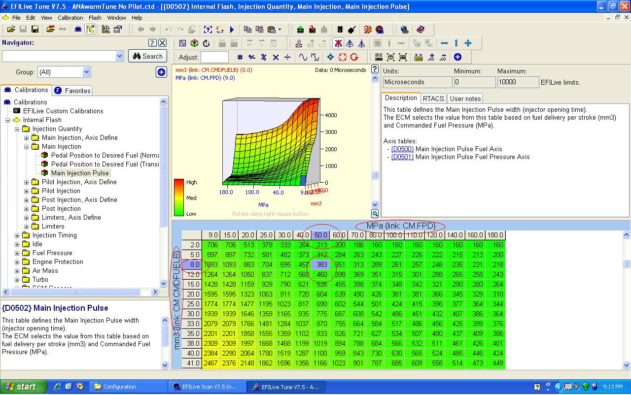

It worked!!!! Thank you so much ScarabEpic22!!! Got it figured out now! Here's the proof in the pudding. Boy have I got my work cut out.
Attachment 11443
That could for all
